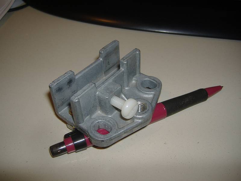

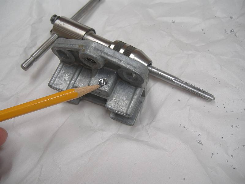

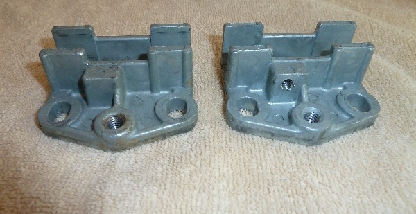

Here are pics from the post. I am practicing uploading. Well,here goes…
[ATTACH]19709[/ATTACH]
[ATTACH]19710[/ATTACH]
[ATTACH]19711[/ATTACH]
tap bracker.jpg (56.25 KiB) Viewed 2229 times
backhertz
Posts: 674
Joined: Mon Jan 28, 2008 1:18 pm
Post by backhertz »
It worked!
One of these days I will have to modify my old bandsaw. I used to enjoy using it years ago as it cut like a hot knife through butter. But one day I was using it & had to take a bathroom break. When I returned, I simply turned the headstock back on & never noticed the speed on the headstock had been turned up to max! Well, the jokester got a big laugh as the blade shot across the basement when I turned the headstock back on to continue. Fortunately, no one was hurt. But in addition to the blade, one of the tires was destroyed.
That was about 23 years ago. I've always double checked my set ups ever since- just because.
Great job on the mod & the pics Ed! I tried looking through the old manual & found zilch on what Seahawk was looking for. I was tempted to remove the part on both bandsaws as they sure looked alike to me. But I figured someone had to have experienced this issue before.
It looks like an easy mod. I imagine Lowes or HD carries the nylon screws in their hardware area. So today I learned something, I can go relax now.

I suspected that mine simply did not have the adjustment, and you folks have confirmed it. I will be drilling and tapping in the morning. The side by side photos are a big help.

I drilled and tapped a 1/4-20 nylon bolt just like in the above photos, and it took out the side play. Getting the other adjustments was a bit "fidley", but it is done.:)
