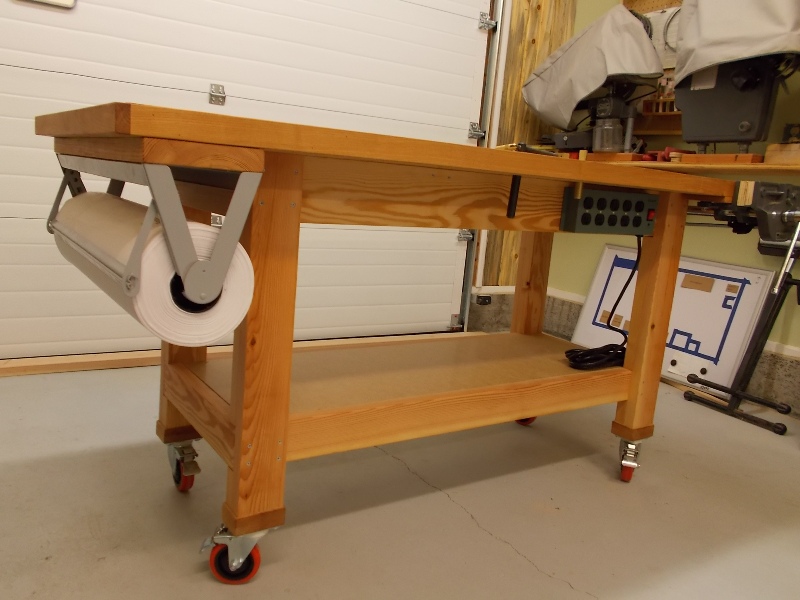

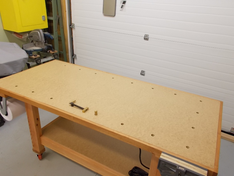

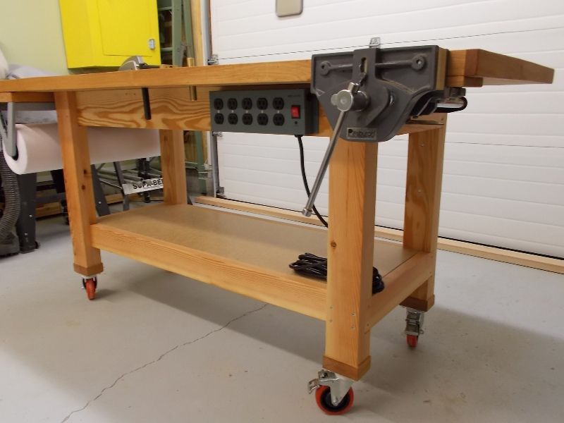

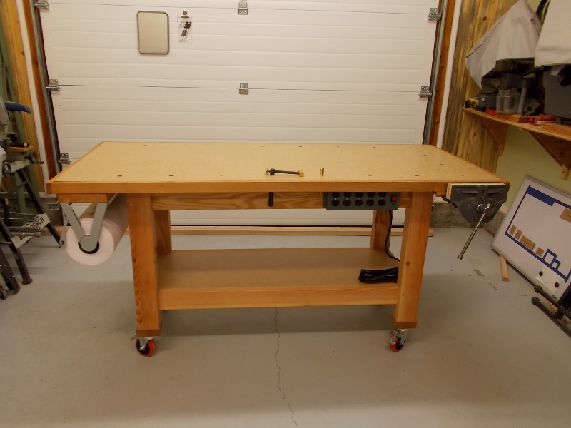

Hi all,
Attached are photos of the new workbench I finished building. The design is loosely based upon plans from an issue of Wood magazine.
The frame is Douglas fir, construction grade 2"x6" lumber. I resized this lumber to make up 2 1/2" x3 3/4" legs.
The size of the top is 32" x 72". The top is made up of 2 layers are 3/4" plywood with a replaceable hardboard surface. This top is wrapped with Red Alder. The feet are also of Red alder.
The reason I chose this lumber is to highlight two of the tree species of the Pacific Northwest.
The finish is an old "Workbench Recipe" that contains 1/3 beeswax, 1/3 turpentine and 1/3 Linseed oil. I applied two coats of this "Workbench Recipe" over a period of 3 days. I have never used this finish before, but I am quite happy with the results.
The casters are 4" double, locking casters from Woodcraft. I would have used the new workbench wheels from Rockler, but I had already purchased these double locking casters. My garage floor has some uneven spots. I have found that moving the workbench a few inches either way solves any "wobble" problems.

Great bench! Why didn't you use the SS as a backdrop in the photos? Never can see too many SS's.
Great looking workbench!Lodgepole wrote:Hi all,
Thanks to all for taking a look at this project. Hopefully, I won't get the snarky comments I recieved when I sent in my "Maintnenance Table" attachment last month.
I liked your maintenance table attachment too, but I may of been guilty of a "snarky comment":( Anyway, I did comment and hope it was not taken as negative feedback, just something that I would have needed to add for me.
Congrats again on a great project.
Sam in Northfield, MN

Great looking bench - well done! I appreciate the red alder touch - it's the most common hardwood around these parts and not often used for much but chips heading to a pulp mill...it's a beautiful wood that recently has started seeing local use for flooring as well.
What issue of Wood did you get your inspiration from?

Hopefully, the following is a complete response to the questions that have been asked regarding this workbench:
The roll of paper is to protect the workbench top when I am gluing up or finishing a project. I have also used the paper to draw out new ideas for possible projects.
The plans can be found in the June/July 2005 issue of Wood. In addition to the workbench plans in this issue, there is another article entitled, "6 Ways to Beef Up a Workbenche". The ideas are:
1. 50 lbs of added weight stability
2. Three tool totes
3. Three wide drawers for tools and plans
4. Paper roll holder for protecting the top from finish spills
5. Surge protector power strip
6. Glue-up clamp holder
As you have notice, I already have installed the paper roll holder and the surge protector power strip. After I use the workbench for a while, I will probably add the tool totes, drawers and glue-up clamp holder.
Thanks for all of the positive feedback that everyone has given!
