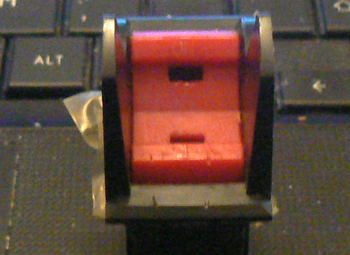

My DC switch has the 'H' shaped hole.
The power station switch has two small rectangular holes.
[ATTACH]20257[/ATTACH]

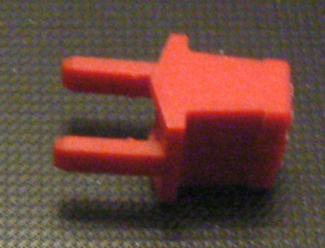

This key is from my 'other' power station. It fits. I am guessing it is like the one you broke(hope I did not cause that!!!!).

JPG40504 wrote:My DC switch has the 'H' shaped hole.

You did not cause that! It has been flakey for months. Today when I removed it, I broke it. Actually, it might have been broken before, even when I was using it.
Since you have a key that fits, you have the dimensions of what you have to insert to toggle the switch.
