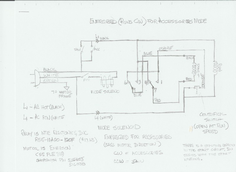

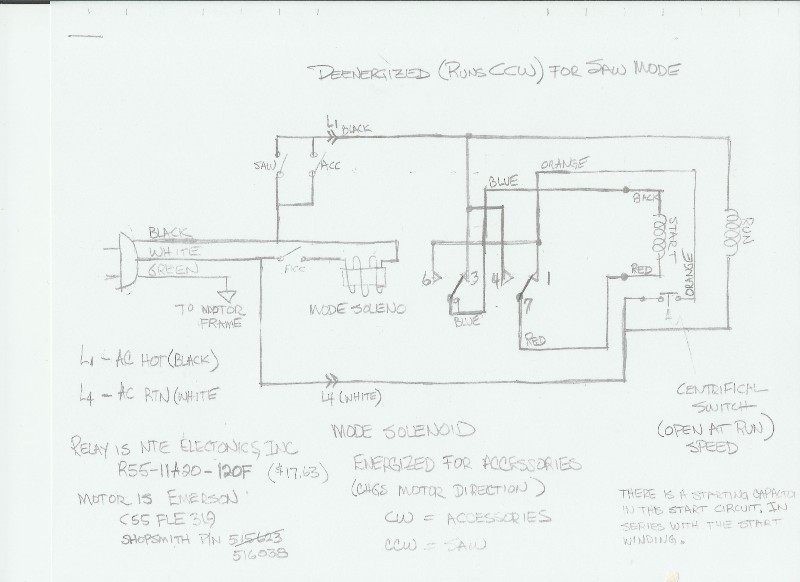

The reverse switch does not work on a crafters station. Bought a new switch from shopsmith, no luck. I sold the unit to a guy in fla. which is a long way from Missouri. Want to help the guy get the reverse going. I did not even know about the reverse on these units until he told me that is what makes them unique and different from the power station. Any suggestions I'm wondering if someone rewired the unit to bypass the reverse. But don't know. thanks for any help in advance. He says the motor is okay.
I have a Crafter Station and when I received it it was inoperative. I had to completely rewire the harness. I'll look for my notes.godavid2 wrote:The reverse switch does not work on a crafters station. Bought a new switch from shopsmith, no luck. I sold the unit to a guy in fla. which is a long way from Missouri. Want to help the guy get the reverse going. I did not even know about the reverse on these units until he told me that is what makes them unique and different from the power station. Any suggestions I'm wondering if someone rewired the unit to bypass the reverse. But don't know. thanks for any help in advance. He says the motor is okay.
There really isn't a reverse switch. There are two switches. One turns it on in one direction and the other turns it on in the reverse direction. The switcheroo is accomplished by a combination of relay contacts. Once understood, it is really quite simple.
I have a Crafters Station and I have rewired it. I'll locate my notes and will try to help.
[ATTACH]20474[/ATTACH]
[ATTACH]20475[/ATTACH]
These two drawings depict the relay and the two switches that control the Crafters Station.
In one. the Crafters Station is in forward mode and in the other it is depicted in reverse mode. The relay in conjunction with the switches controls which.
These drawings are worth the value of at least one Crafters Station. Shopsmith documentation was meaningless (at least to me). I had to create these one wire at a time. My wire harness had been scorched (no melted into a glob) when I acquired the CS. I've had no problems with it since the rebuild. I've had it about two years.
I really don't know why it never caught on in the market place.
One word of caution. When it is running and you want to change directions, turn it off and let it come to a complete stop before turning it on in the other mode.

- Corrected Drawing (Deenergized).jpg (65.41 KiB) Viewed 2977 times
- Corrected Drawing (Energized).jpg (65.78 KiB) Viewed 2974 times

Dusty, in yer wiring drawings, is CW/CCW as when viewed from the internal motor's point of view?( which would be opposite of the users external point of view looking at the shaft end).

I always have problems with this. CW or CCW. CW equals Saw Mode. CCW equals SPT Mode. Is that from the motor's point of view or the user's?JPG40504 wrote:Dusty, in yer wiring drawings, is CW/CCW as when viewed from the internal motor's point of view?( which would be opposite of the users external point of view looking at the shaft end).
JPG40504 wrote:I assume the crafter's station has the same smaller motor as the power station. If that be correct, it would be underpowered for a 10 in saw.
Yes, it is the same motor as that in the Power Station (1/2 HP I believe). However, I do not find it to be under powered but then I don't find the Mark V to be under powered. Yes, it obviously has less power but whether it it adequate or not depends on what you need for it to do.
It is a "Crafters Station" and not a construction saw.
I would not chose it to take onto a construction site to cut a lot of timber just like I would not chose to sprain paint my house with my electric spray gun.
THIS TURNED OUT TO BE COMPLETELY FALSE> I ended up using mine as a table saw on a work site - cutting 2xs for house and garage framing. House and garage are built and the Crafters Station still runs fine.
dusty wrote:I always have problems with this. CW or CCW. CW equals Saw Mode. CCW equals SPT Mode. Is that from the motor's point of view or the user's?
So CW/accessories from the motor's point of view on your diagrams, and CW/saw mode from the user's point of view here.
They be flipped, hence the question.
I do not know what is de rigor pertaining to motors. Sortsa like what is a left/right handed door.
