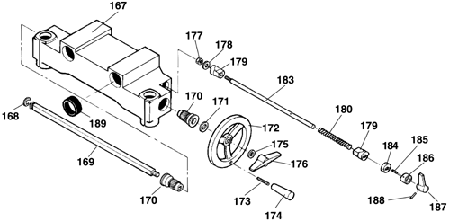

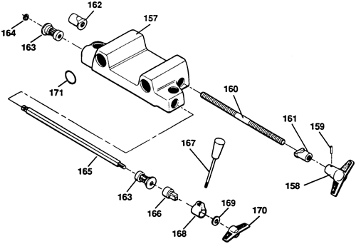

You probably have a 500 judging by the number. You can also tell by the size of the table and the table carriage. The carriage on a 505/510/520 has a wheel on it also. Ebay and craigslist are the places to sell these. Here are some pics of table carriages
- Exp_500Carriage.gif (23.27 KiB) Viewed 17994 times
- Exp_510_520Carriage.gif (23.52 KiB) Viewed 17985 times
