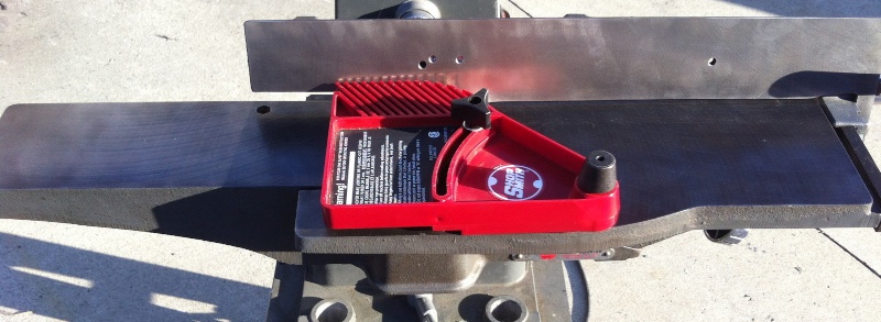

Just recieved the Jointer I bought off of EBay. Looks good to me, I'm excited to get in the shop this weekend and set it up.
My only complaint is that you guys ran the bidding up a little higher than I wanted. :D We need to come up with a lottery system on the nice SPT's so we're not all bidding at once!:rolleyes:

I have mine so I did not bid. Looks like new! Congratulations.
Are you powering this with a Power Station or with a Mark V? If using a Power Station you might want to minimize depth of cut and reduce feed rate to improve cut quality.
The Power Station is just a bit weak and slow for the jointer. My Opinion!

The picture was from the auction. I'll be running it on my Mk 5. This is the first jointer of any type I've ever owned. I bought the instructions from SS and have read those, but I'm sure it's going to be a learning experience.
Start your evaluation by making sure you have flat, coplanar tables at zero depth of cut.
Then make certain your blades are sharp and that all three blades are precisely the same height.
Maintain downward pressure on the piece as it goes across the outfeed table and you will be making fine shavings.

Just your fingers out of the blade so that any mess up can be considered a "learning experience" and not a shop accident. I strongly recommend the use of a push block for any and all flat jointing. For edge jointing I use the push block to keep the work piece flat against the fence. For surface jointing I use it to keep the piece flat against the table.
