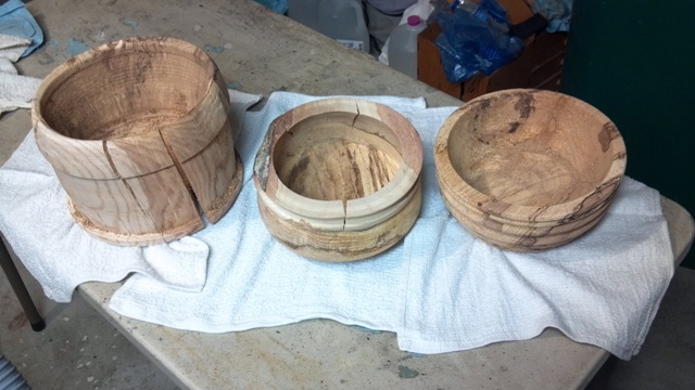

So, here is what could happen when you turn green bowls and place them in bags with wood shavings for a few months. In this case, 2 out of 3 I turned and stored in January cracked. I am gaining experience in how to prepare the blanks so that the cracking might be reduced.
[ATTACH]20790[/ATTACH]
I believe the one on the left is beyond repair. Unless I can mix up some glue and sawdust to fill in the crack. I might be able to do something with the center one by cutting in down before finishing on the lathe. The third one is crack free as of now. I have 6 others in various stages of drying and I hope they come out ok.

Rather than sawdust and glue, you can also use any of the following.
Polyester Resin (PR)
Fiberglas resin
Polyurethane Resin (Brand Name = Alumilite)
Epoxy resin
Any of these can be tinted or colored as desired.
The PR and Alumilite are very popular with the pen making community. Alumilite is preferred as it does not shrink as much.
I have saved bowls and spindles with both fiberglass resin and PR.

Fred,
Are you saying that you turned your bowls while green, then set them aside to finish drying, and they cracked? I thought that is what you are supposed to do with bowls. Turn the blank while green, then set up to dry, and then do the finish turning.
