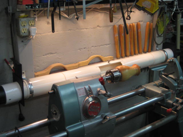

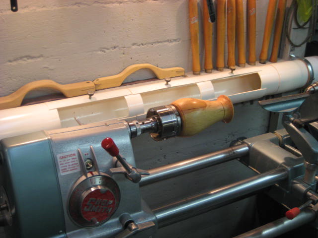

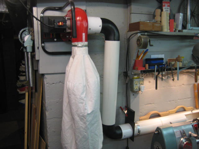

Just finished my dust collection for my Greenie.
Got the idea from Woodcraft magazine June/July issue.
Works great
Works great

This is a very subjective situation. Your "too much" and my "too much" are almost certainly two different amounts.burkhome wrote:Looks interesting...how effective is it. I have tried many things with my SS and none have been as effective as I would like. This is similar to a couple of things that I did and too much ended up on the floor in every case. Still looking for a solution.
I am resigned to the fact that when I make sawdust and chips I am going to have to use a broom.

Has anyone ever tried a very large funnel connected to the vac sys and move or adjust the funnel to catch the largest amount of chips falling down? With lathe work, you may need to make the funnel large enough to stand in.
I think Dusty has it right, you'll just have to sweep. Maybe its a little less trouble anyway and its good exercise!

See my little gulp system here:pieceseeker wrote:Has anyone ever tried a very large funnel connected to the vac sys and move or adjust the funnel to catch the largest amount of chips falling down? With lathe work, you may need to make the funnel large enough to stand in.![]()
Very nice Greenie BTW!
https://forum.shopsmith.com/viewtopic.php?t=10012
It is not only for pens anymore and it works pretty well for small turnings that I have done. Have yet to try it for longer work pieces where it will have to move along with the cutting.
Here is another place to have a look at it:
https://forum.shopsmith.com/viewtopic.php?t=12783
As you can see the larger chips gather but the finer dust gets sucked up. When the mass of chips get large enough it gets gulped up. I'm going to give a wax job to see if that will make amount of chips staying in the funnel less.
I like what you've have done. I no longer get any magazines so I miss out on seeing project like this, so thanks for sharing.yellowbug wrote:Just finished my dust collection for my Greenie.
Works great
Seems like a floor level gated collection point could be added so the remaining bits on the floor could be swept into and collected in short order.
Thanks to all, I only use it when I'm sanding, gave up on trying to suck the flying chips, need a jet engine for that. The only thing I'm going to do is move the blower unit down to eliminate the elbows.
