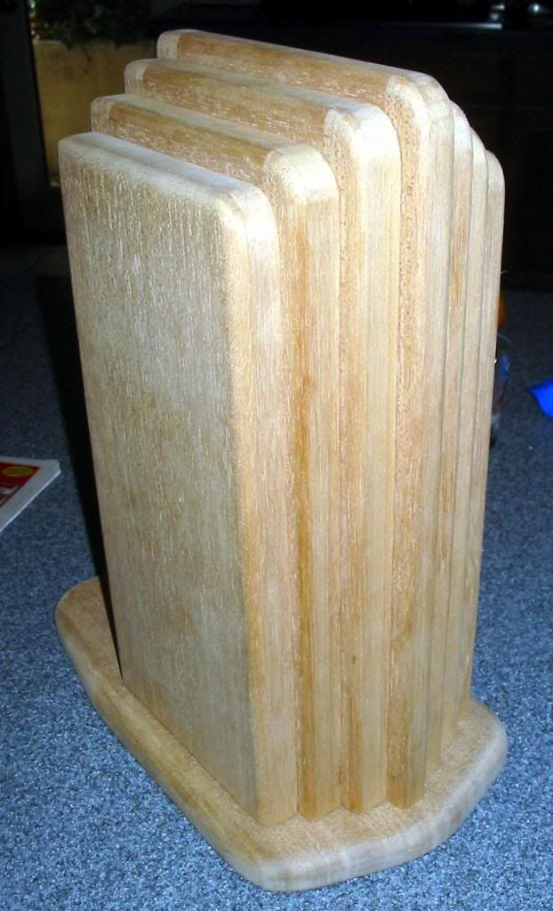

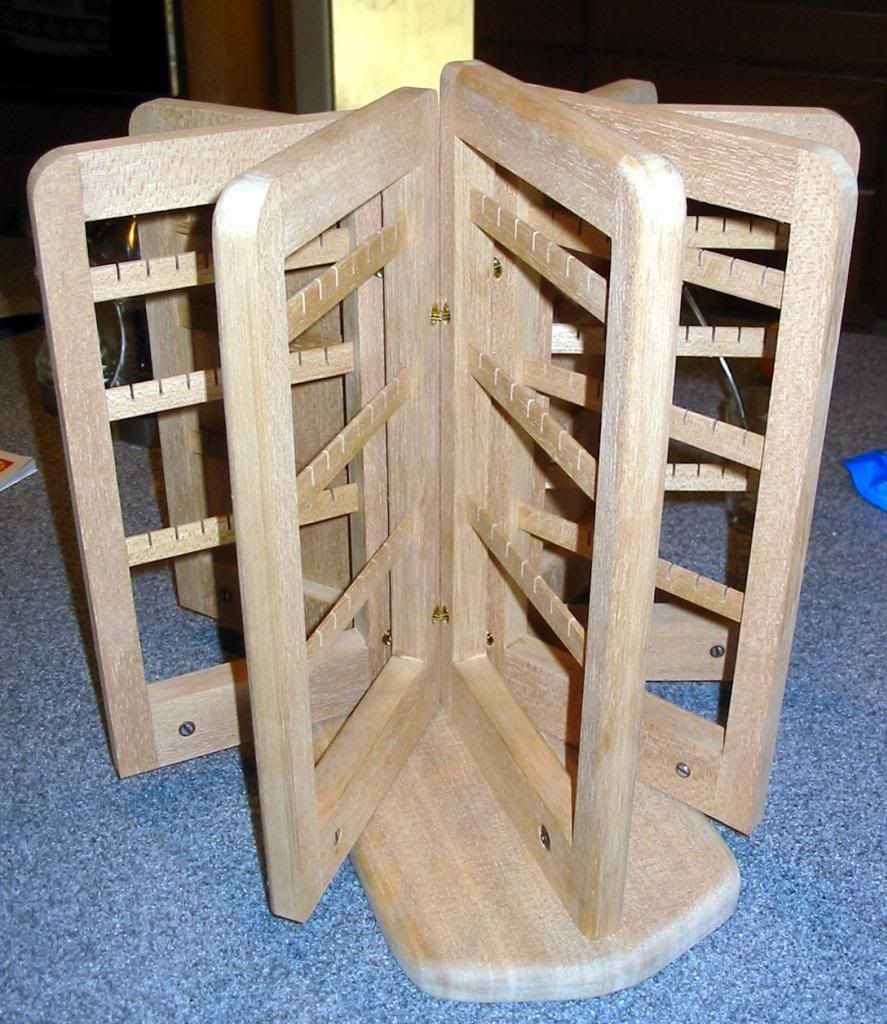

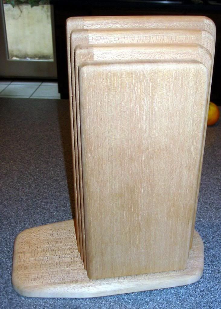

An earring case: Test assembly before applying the finish. There are a few warts.;)
To get a sense of scale, the cross pieces that support the earrings are 5/8" wide by 1/8" thick. Loose tenon joints along with the hangers offered a good test for my Shopsmith supported Jointech system in cutting the many mortises safely. The Shopsmith came through like a champ for resawing and cutting the slots to hold the earrings.
Rob in San Diego

Planning an antique oil and then some good old JPW. It looked good on a sample piece I made up.
Rob in San Diego

I cannot take credit. I downloaded the free plans last October via the Woodworkers Journal E-zine. The plans are, WJC135 Art Deco Earring Chest. Though the plans call for maple, I had the piece of mahogany that I had reclaimed from a neighbor.
Rob in San Diego

Like the 'snap' screws in addition to the hinges. Source?????:confused:
Do please show it to us after JPW!;)

[quote="JPG40504"]
Rockler's got em:
http://www.rockler.com/product.cfm?page=270&site=ROCKLER
So does Woodcraft:
http://www.woodcraft.com/product/2001076/10374/soss-nonmortise-hinge-for-12-panels.aspx
different barrel size for different stock thickness.
