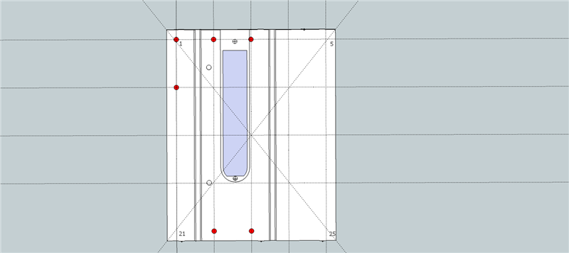

So how should I interpret the numbers in the corners of the drawing? The thickness of feeler gauge that fit under the straight edge at those 4 points? Which way was the straight edge oriented when those readings were taken?dusty wrote:I have opened this thread as an extension of that discussion currently going on in Can Truing The Table in DP mode Cause Heeling In Table Saw Mode?
To better communicate what I am seeing when I test my table, I am going to post the dimensions at each intersection of the grid shown on the attached diagram.
I already know that my table dips on the right out feed corner about .008". The rest of the table is flatter than that.
I have shimmed an de-shimmed the table a number of times and right now I do not know whether it is shimmed or not.
I have a 48" Starrett straight edge and a set of feeler gauges that will be used to make these measurements.
[ATTACH]21742[/ATTACH]
For this I must apologize. I was just too lazy to number all of the test points of which there are 25. The test points are numbered left to right, top to bottom 1 - 25. Only 1, 5, 21 and 25 are actually labeled.algale wrote:So how should I interpret the numbers in the corners of the drawing? The thickness of feeler gauge that fit under the straight edge at those 4 points? Which way was the straight edge oriented when those readings were taken?
The chart as it exists tells you nothing about flatness; only where I am going to take measurements.
Table Flatness

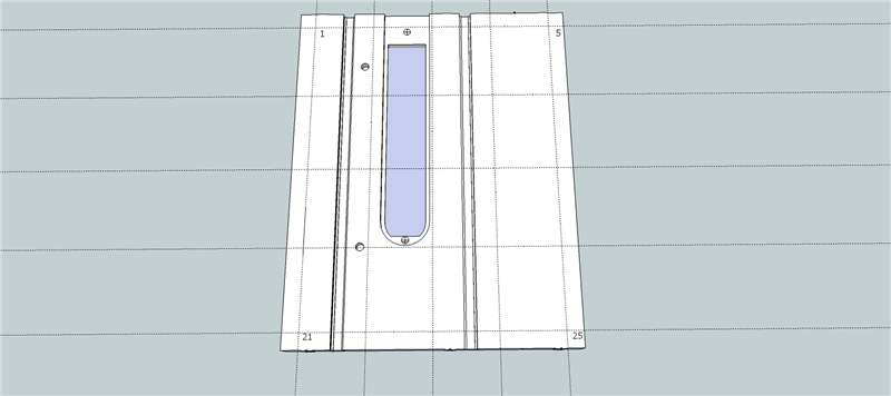

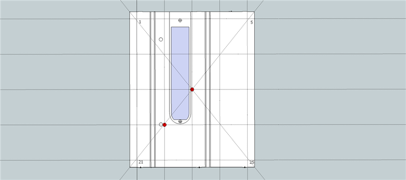

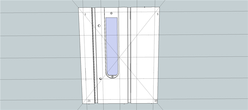

These images are marked with a red dot at those intersections where the readings were >.003 (an arbitrary standard for table flatness).
There are three charts. I tested with the straight edge aligned side to side, infeed to outfeed and diagonally. The dotted lines depict where I placed the straight edge.
The red dots indicate locations where the measured gap was greater than .003". If there is no red dot, the reading for that specific test was less than .003".
This test was performed on a table that has no ribs in the area between the miter slots.
[ATTACH]21748[/ATTACH]
straight edge positioned side to side
[ATTACH]21749[/ATTACH]
straight edge positioned infeed to outfeed
[ATTACH]21750[/ATTACH]
straight edge positioned on the diagonals
For all practical purposes, I consider my table flat except when setup as a drill press.

This is hard for me to admit but I am not certain that all this data provides any useful information.
Notice that there are NO out of tolerance locations indicated on the first image. This image is for those measurements taken with the straight edge positioned side to side on the table.
The lack of out of tolerance (.003") measurements would tend to indicate that the table is perfectly flat but when I move the straight to the infeed, outfeed position, a number of out of tolerance positions are found. These are low spots.
I am not able to rationalize this but trust me, I have checked and rechecked those observations.
Glad you said this because I have been trying to figure out what the data means.dusty wrote:This is hard for me to admit but I am not certain that all this data provides any useful information.
If I had to make a WAG, I'd say you've got an ovalish shaped hump running front to back somewhere in the rectangle formed by location points 7, 17, 19 and 9. (Coincidentally (?) this defines an area box a little wider and a little longer than the the trunnion attachment points. Perhaps the trunnion screws are pulling/squeezing the area of the table together slightly to form the hump?) When you put the straight edge side to side there's little deviation because you are reading points all along the same elevation of the hump. Front to back the deviation is revealed because the high points in the middle of the table show up as low points at the front and back of the table. This doesn't explain the diagonal readings. Perhaps the low point reading at point 17 is a trunnion attachment point?
