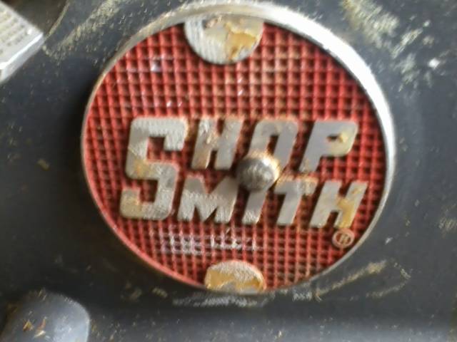

SS SN 24837. I think that puts the production date just shy of 1980. How do I get to the switch Internally. Normally there is a set screw and a pivot pin, but here I have a pin in the center only. Is this an obsolete factory set-up, or is this a "customization." I can guess at how to take the head stock apart if I have to. I think I will take the head off if testing guesswork and that will add to the process. Afraid if I start randomly disassembling the headstock things will unexpectedly come apart a lot more than I want. I would really prefer not to spend the next two days learning the machine inside and out. Probably upgrade to an MKC 2 bearing quill shortly and will learn more about it then.

Answer for progeny @ 3:32: pry it off .
