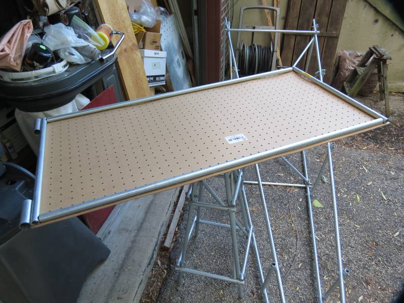

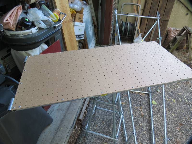

So this is my latest conduit project. It is a project and a test at the same time.
The concept is to make a sliding pegboard piece that will ride along in front of a shelf system thus allowing access to the shelf about half at a time.
The frame of the pegboard is made out of 1/2" conduit. Using self tapping sheet metal screws though holes in the pegboard then into the conduit.
[ATTACH]22018[/ATTACH]

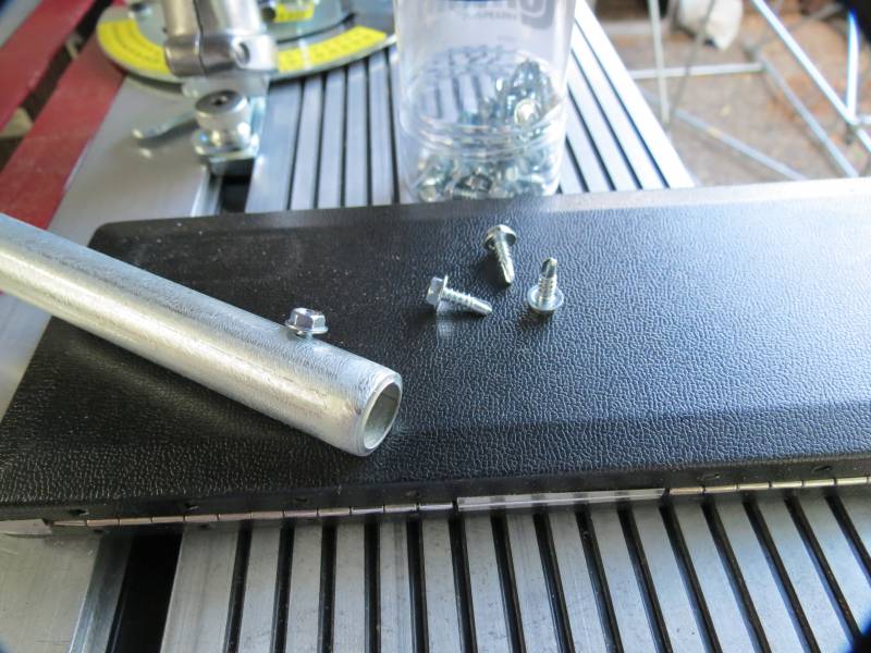

The pegboard is used to locate the placement of the sheet metal screws.
[ATTACH]22019[/ATTACH]

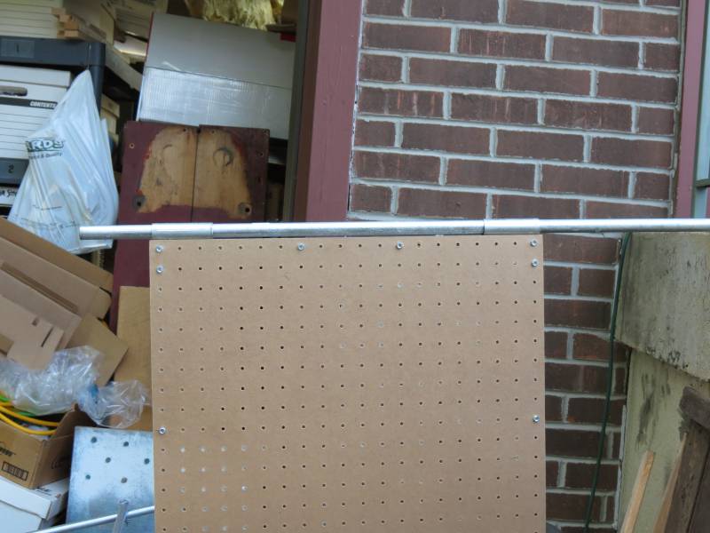

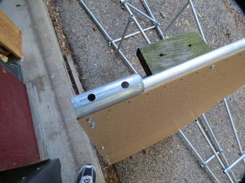

The backside
[ATTACH]22020[/ATTACH]

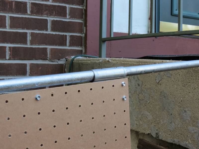

The hanger bit is a 3/4" piece of conduit, the top holes are getting a screw driver into to tighten the screws shown in the next picture.
[ATTACH]22021[/ATTACH]

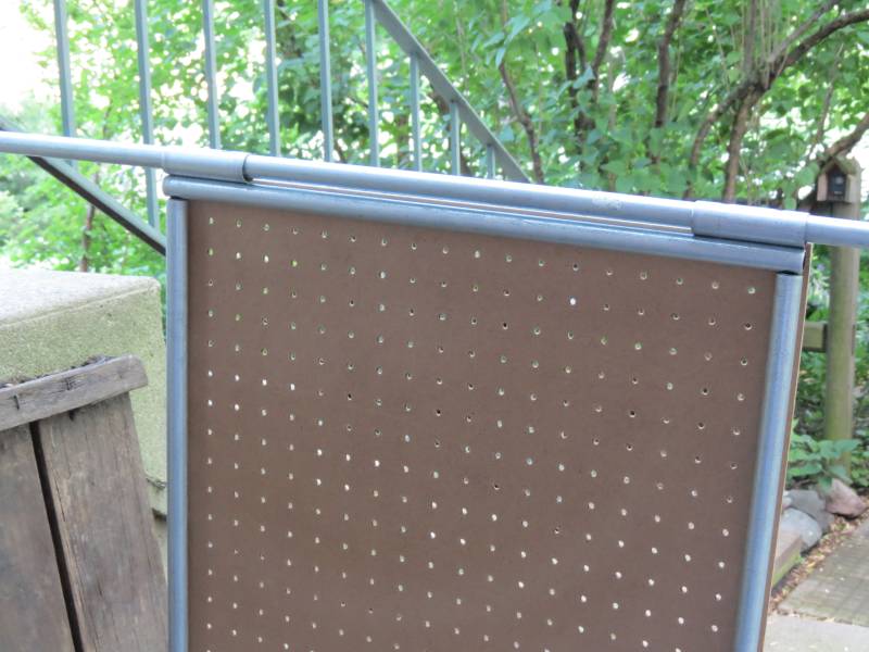

[ATTACH]22022[/ATTACH]
More to come.

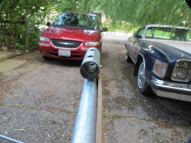

The rod will be another piece of 1/2" conduit. I'm thinking a coat of wax or some thin lube will let things slide easy enough because the intended load will not be excessive. Time will tell on this.
[ATTACH]22023[/ATTACH]
[ATTACH]22024[/ATTACH]
[ATTACH]22025[/ATTACH]
I don't have the shelf yet so I can not mount or test it. The bottom will ride against a board to keep the pegboard vertical. So that is about all I can show you at the moment.
