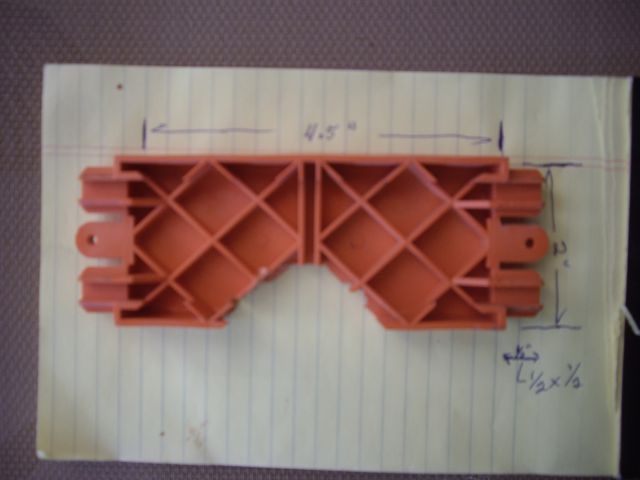

Any of you guys have a source or work around for the plastic inserts for the fence?
Thanks.
Gene

A picture or two of the insert with a ruler beside it could help us without the Jointech offer some ideas. Thanks.

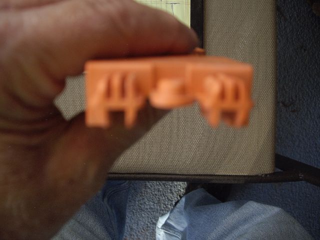

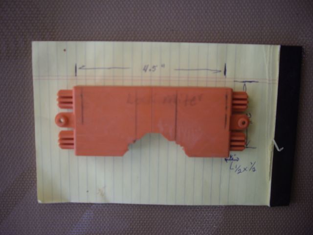

Here ya go.
The back wouldn't need to be like this one. It's 3/4" thick at the edges. As Ed indicated, 3/4" might be a tad thin to put those 1/2" pins in.
Looking at the blurry picture of the end, I'm not sure that middle pin needs to be of that configuration. It could probably be just like the other two.
Thanks for looking Bill, and anyone else with an idea.

wlhayesmfs
Posts: 667
Joined: Fri Jul 21, 2006 10:50 am
Location: Broken Arrow OK
Post by wlhayesmfs »
I will also keep an eye on this post, I got a really nice Jointech system when I picked up my 520. I have a few inserts left but will know I will need some in the future.

Gene Howe wrote:Bill,
Here ya go.
[ATTACH]22731[/ATTACH]
[ATTACH]22732[/ATTACH]
[ATTACH]22733[/ATTACH]
Gene, I would probably 1/4" dowels to mount the 1/2" pins. That way I could keep the thickness of the insert at 3/4". Fortunately, I think I still have about a half dozen inserts left for my Jointech.
An alternate approach would be to utilize the t-slot on the face of the fence to hold sacrificial pieces to create a zero clearance fence. This is the approach that Incra uses on their fence.
Rob in San Diego

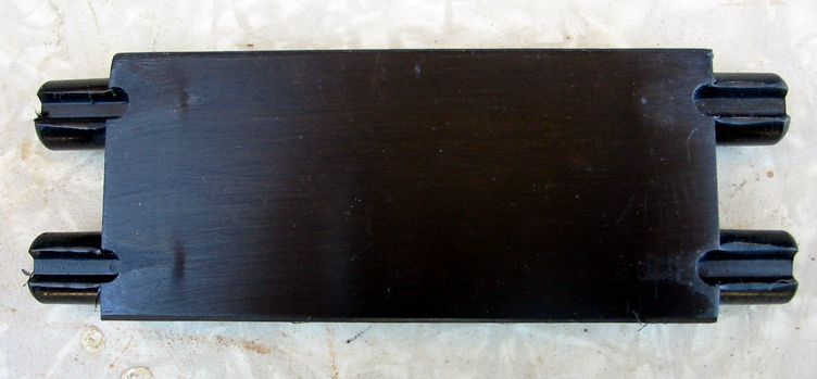

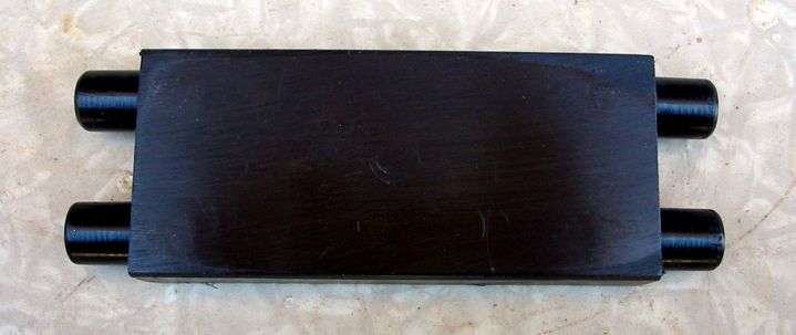

Here are pictures of one of the newer style inserts that I received from Jointech.
[ATTACH]22741[/ATTACH]
[ATTACH]22742[/ATTACH]
The dimensions of the body are 2" x 4-1/2" x 3/4" and the pins appear to be a fat 1/2" in diameter.

Gene Howe
Posts: 3219
Location: Snowflake, AZ
Post by Gene Howe »
Thanks a bunch, rob!
Looks like they did away with the center plug. I didn't think it did much, anyway.
Is the first pic the back?
Gene

Gene Howe wrote:Thanks a bunch, rob!
The first picture is of the back.
