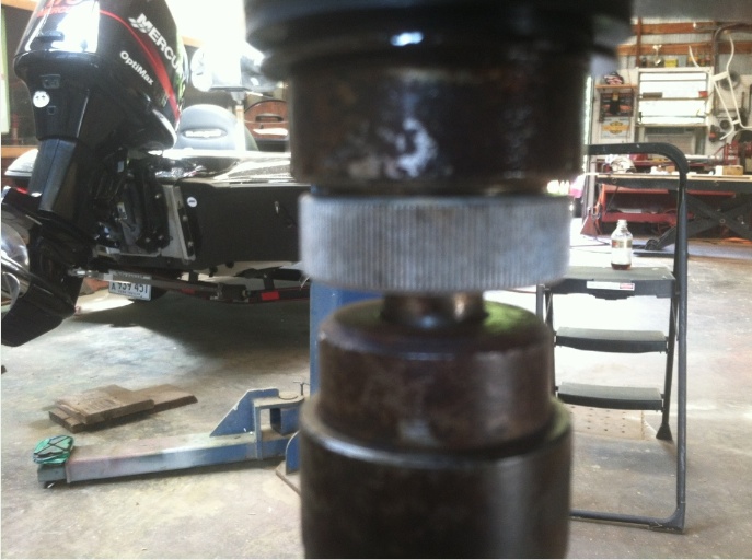

I didnt hammer on the quill, "per say" I tapped on a ring that looks to be a grooved twist grip while holding pressure on the quill handle. The quill had a rust area that was holding it, like from moister.
I will post a pic of the lower quill and grip.

I forgot the pic
IMG_1159 2.jpg (117.54 KiB) Viewed 2489 times
Tapping indeed. Anything more forceful may have driven it off the shaft.
Have you tried to get the drill chuck off? Another set screw. That one should have a flat point.
The knurled collar is also retained by a set screw. Both the collar and the drill chuck have a tapered flat on the shaft they mount on. The collar need only be removed if replacing the quill bearing.
Be careful if getting the drill chuck off becomes troublesome. That shaft is what everything that is power driven attaches to. The end of the quill that is 'below' the retaining ring and rubber ring also is an attachment surface.
