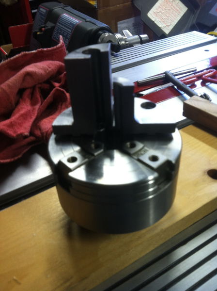

SO..... when Nova advertised their Pen Plus jaws, I waited to see what the different forums would say. Reviews were a bit too mixed, but having just ruined a couple nice plastic and one expensive wooden blank, I bit the bullet and ordered the Pen Plus through Amazon (with their great return policy I figured why not),
They are significantly (IMHO) better then the pin jaws,
They are much longer and even though they only have two jaws total, they hold very securely.
Comparing the length Pen Plus (left) and pin jaw (right)
[ATTACH]23086[/ATTACH]

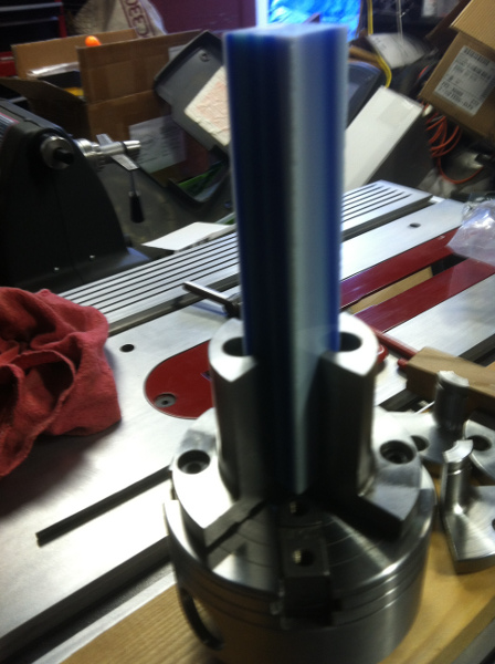

And the same blank in the Pen Plus. The half circles traveling the length of the jaw seem to allow for a better grip and each jaw uses two screws to hold it in place - one accessed via the long tube/ circle).
[ATTACH]23087[/ATTACH]
Whether you think it is worth the extra $38, is of course based upon your wallet, tolerance level for adjusting blanks, and how good you are at using other methods. Personally I sucked at the other methods, my tolerance levels for mistakes seems to reduce based upon perceived pleasure, so the wallet took the hit!)
Me, I like it! :D :D
