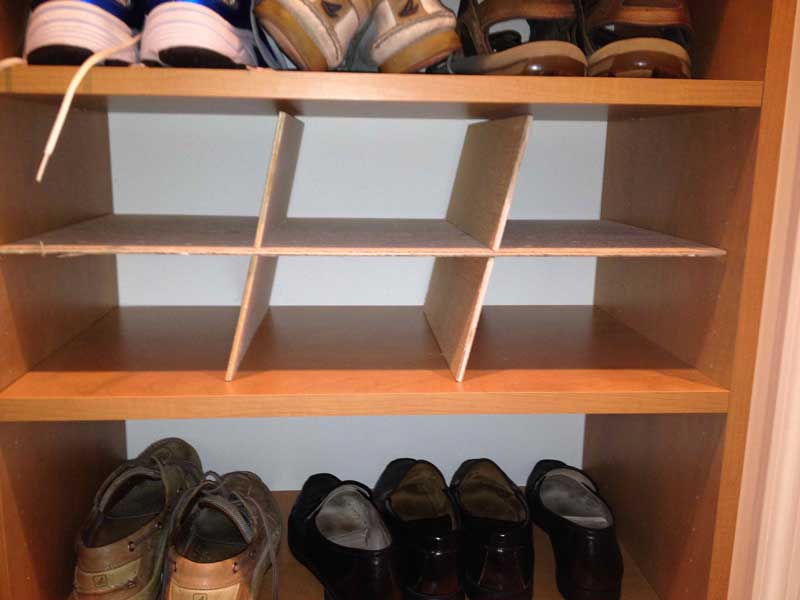

I want to build a partition for a space 24 x 14 x 9. I have done a trial partition using 1/4" plywood but it is too flimsy (see attachment). The parts fit well just not stable. What am I missing as to a more stable partition?

If it were me I would simply nail some cleats on to the existing shelves to hold the dividers in position. I would put two, one under each end of the horizontal board and four more, two each on the either side of both vertical boards. I imagine simple 1x1 cut the length of the shelf depth would work perfectly.
Using cleats would allow the dividers to be easily removed should you decide you want to.

rayj wrote:I want to build a partition for a space 24 x 14 x 9. I have done a trial partition using 1/4" plywood but it is too flimsy (see attachment). The parts fit well just not stable. What am I missing as to a more stable partition?
Did you glue the veticals to the center horizontal?

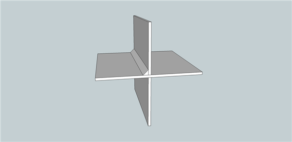

If you don't want to permanently join the verticals to the horizontals, maybe this would work.
[ATTACH]23222[/ATTACH]
Placing a support piece in each corner.
This would stabilize the shelves while allowing them to be removable; leaving no trace of having been there on the original shelf.

After I saw the picture a solution jumped to my mind but Dusty has already posted it. It looks like a good solution to me. Just cut one or two long pieces and chop up enough for all of the corners. It should become sturdy and still be a lift out divider.

What is missing is a tight joint(notches?).
That is difficult with thin materials.
The cleats are the only practical option IMHO.
They do not need to be large(although bigger is gooder!).
I think one on both sides of the vertical partitions that are glued to the underside of the horizontal partition will make it rigid enough to support the shoes. 3/4" cove molding oughta work.

two more cleats might help
Since you have 'flimsy' material you might put a cleat under each end of the horiz piece - out where they meet the sides. That way any material on the 'shelf' won't bend down the shelf at the ends. If installing a 'permanent' cleat to your bookcase wall is not a good idea, then hope for the best or put the heavy stuff in the middle 'shelf.':)
