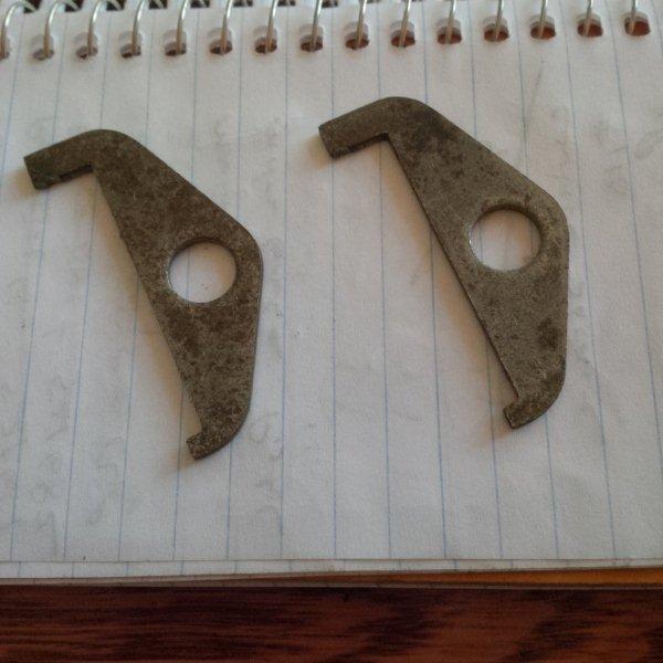

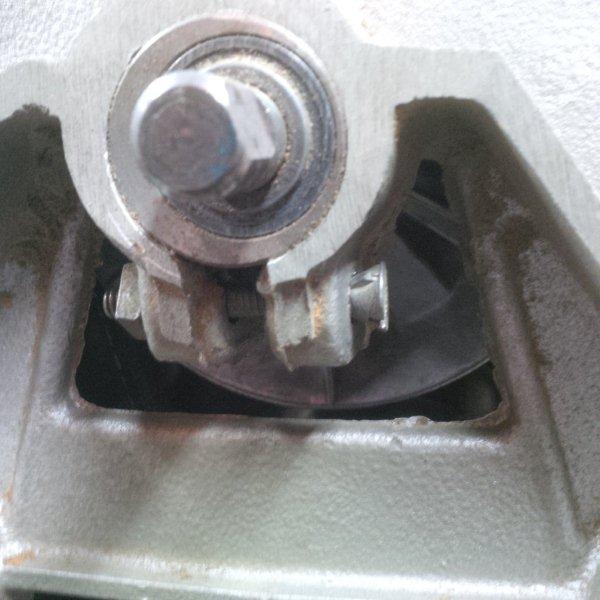

This is what I found when I opened the machine up, the eccentric is obvioulsy in backwards but the weird pinch bolt caught my attention too. After reading about the u shaped retainers I remembered seeing these in the box of parts and manuals that came with the MkV, are these the retainers that are supposed to be installed? I compared the idler shaft that was in the machine to one from a newer machine and the keyways are cut different. This machine has a keyway without the depression for the kink and it also gets shallow at the gilmer drive end and it stops before the end of the shaft at the control sheave to keep it from walking out the end. Thanks Bill for the info, will be contacting you for some parts to bring this SS back from the dead. Great Forum!

Those be de ones. The longer finger faces the open end of the headstock.
FWIW, I do not like the screw in the clamp. A flat head screw needs to be used to spread the clamp force over a larger area than the funky flat head screw shown. I would absolutely replace it!!! When doing so put the head on the side with the access hole.
Do not be a gorilla when tightening that screw. A split ring lock washer under the nut will provide a good torque indicator. Tighten until the lock washer becomes fully flattened and stop(more wisdom from the man in Plant City).

Is there supposed to be a spacer or washers along with those u shaped retainers? They rattle back in forth in the slot even when the pinch bolt ( a new one) tightened down snug. Maybe I got the wrong idea how these work, anybody got a photo of what the looks like correctly installed? Bill, aren't you working on an early A headstock? I also don't like the feel of the idler shaft bearing, anybody have an opinion on the aftermarket shafts from eBay or do I just order the new style (with the split eccentric) from SS and wait weeks for it to arrive?
