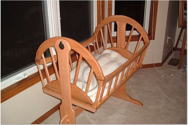

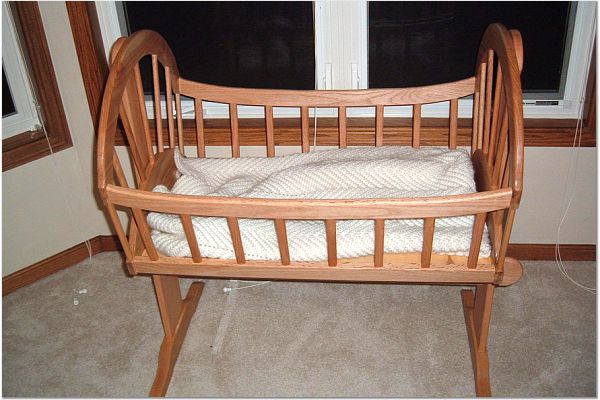

Piece #1 the cradle I made by taking a few basic dimensions from a plan in Wood magazine. The rest was based of a picture I found online and my imagination. I ended up using pivot hinges from Rockler and bed bolt covers from Horton Brass to make it rock and an old church key in a hole drilled in the end to lock it horizontal. I must say the most fun was the mortise and tenon connections at an angle. Since I have minimal experience I tested it by putting both our Beagles in it (about 80lb in total. Did I mention I work for a German Engineering company:) ) It passed the test with no problem. The project took me about 2 months of weekends and some nights after work.
I haven't taken my lathe duplicator out of the box yet so I opted for 1/2" thick by 3/4" wide stock rounded over for the slats. The wide openings between the slats were a conscious decision based on the cradle is only used with bumpers otherwise I would have followed the requirements for a crib.

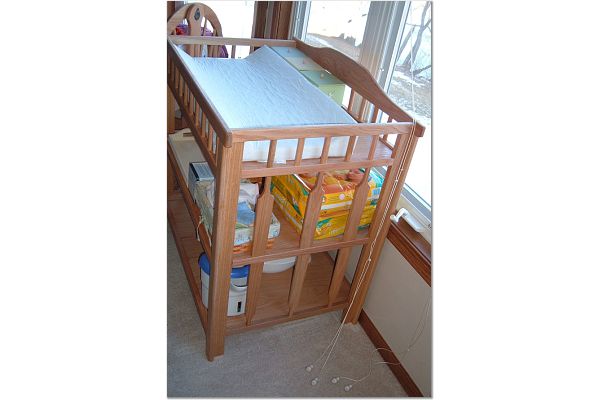

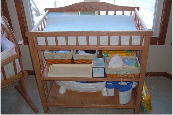

Piece #2 The changing table came from going with my wife to BabiesRus and saying I can make that from some scrap and a sheet of plywood. I just did one of those it's about this deep by about that long and as my wife is 5 foot even everything I make ends up a bit shorter than they sell in the store. Since I had already purchased the plans for a crib from Rockler I incorporated the slats from the cradle around the top and the slats from the crib on the lower side sections.

Really nice work, Andy! I love the joinery and the well designed smooth curves throughout! Nice finish also! Very impressive - especially for an engineer.
Now you'll have to start thinking about duplicating these things plus another dresser for your next bundle of joy!
