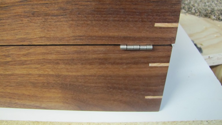

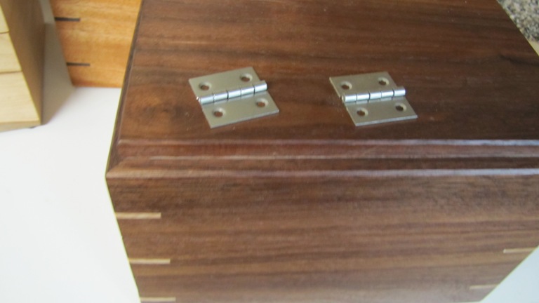

So, I am almost done with these recipe boxes and the only hinges I could find local, and on short notice were these. My bride is not happy with them unless I mount them on the inside. They aren't very thick, do I screw them on flush or try and mortise them in at this late stage?
I should have thought this out a little sooner.
They are maybe 1/32 thick

You should be ableto get the same size hinge in brass from Ace or some other store. As for mounting them inside the box, I don't think that it would work with your design.
Bill V
How thick are the sides? I would mortise them IF the sides are thicker than the hinge leaf. If not I would look for smaller hinges. If SWMBO is the recipient, they could be added later.

1/2 inch and yes, barley smaller than the thickness of the sides.

Definitely mortise them in. If you don't mind the work you can grind/sand some of their width off so you can actually move the pivot point inside the edge of the box. Then if you mortise them fully it will be concealed for all intent and purpose. You still have to allow for room for the lid to open but I have seen these inset to the point you could only see the hinge by looking at the back straight on and the barrel of the hinge could be seen recessed in a groove
Ed in Tampa
Stay out of trouble!
I agree with what Ed in Tampa said!:) Shouldn't be too difficult, given the craftsmanship you have shone on the box. Pencil marks and sharp chisel is all you need.
