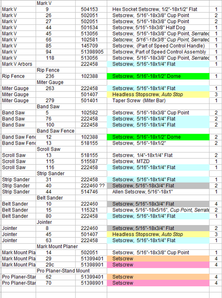

what set screw should be used? item no.?

ruggini wrote:what set screw should be used? item no.?
This might help.
[ATTACH]23791[/ATTACH]
The information in the first three columns is nothing more than a compilation of data contained in the Shopsmith documentation for the various pieces of equipment. The description in the fourth column is my determination of what the part should be. Shopsmith does not, to my knowledge, record this information anywhere that is accessible to the user. Use at your own risk.
The number in the fifth column represents the quantity used at that specific location.
- Set Screws Capture (Custom).PNG (232.69 KiB) Viewed 1940 times
