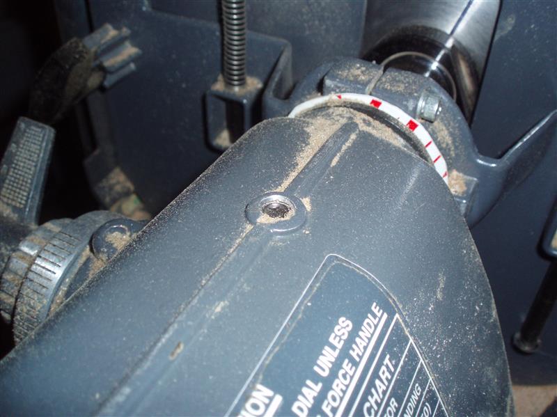

I see in another post that you have mastered the art of woodshop photography so yes, a photo off your headstock showing the set screw might help.
[ATTACH]23820[/ATTACH]
BTW: You can see the location of a second similar set screw in this picture (down and to the left). It is also associated with the quill and may be similarly covered with putty.

Dusty, off topic here, but do you mind explaining what the white ring with the red index markings on the quill is?dusty wrote:I see in another post that you have mastered the art of woodshop photography so yes, a photo off your headstock showing the set screw might help.

I don't mind explaining but you'll have to be patient with me while I attempt to remember why I put that in.algale wrote:Dusty, off topic here, but do you mind explaining what the white ring with the red index markings on the quill is?
Al
Without remembering why, what it does is limit how far the quill retracts while at the same time changes the relative position of the lower saw guard and riving knife.
This is getting really bad:(! I don't remember why I did that.
Quill Stop setting
On the 'back' side of the quill feed shaft is the quill 'stop' stuff. It allows one to control the maximum distance the quill is extended from the headstock. This allows depth control when drilling etc.
In addition to the handle(if it is on that side) are a wing nut and a collar with red(might be black) markings containing the numbers from 0 to 4 and tick marks representing fractional inches.
With the wing nut(labeled quill stop of all things;)) loosened the collar is free to rotate, but with a stop.
By extending the quill to the desired 'depth', rotating the collar until the 0 lines with the index mark(this also should be the 'stop' so ya do not need to 'look', just rotate CCW until the collar hits the stop), tighten the wing nut, then 'raise' the quill.
When retracted 'up' the collar will indicate the depth the quill will extend prior to reaching the stop.
When 'tightened', the collar indicates the distance remaining to the stop.
When loose it means nothing.

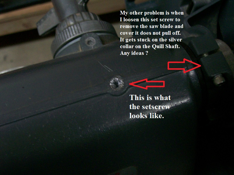

Alright Dusty. Here is a picture of what mine looks like. Shopsmith information said to dig it out but I used a sharp pin point punch and it does not get me to where I can put the Allen Wrench in. This is why I asked if I might have to drill and tap this out and wanted to know the Allen Scree Size for it. Unless you have anymore suggestions for me. I also added some text annotation on it to ask about the other problem which you will see. Thanks for any help and I appreciate it very much.
Update: For the second question I got it solved. I feel dumb now as I forgot to just loosen the set screw on the Arbor.
