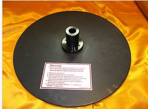

I'm a new owner of a 510 that did not come with a sanding disk. What do I want to pick up? Alum? Steel? Velcro? etc?
cantputt wrote:I'm a new owner of a 510 that did not come with a sanding disk. What do I want to pick up? Alum? Steel? Velcro? etc?
Shopsmith steel with long(505-520) arbor.
Velcro is a personal 'preference'. I do not like it. But then I have several discs. The velcro is 'removable'.
The older aluminum discs and the shorter arbor will work, but only off the side of the table.

Just my luck. Allready sold. Is this one the correct arbor? This seller has some other parts I could pick up also.

That hub looks to be for a mark5. Also some rust on the disk.. You'd do well to know the shopsmith new price when looking at ebay items. http://www.shopsmith.com/ownersite/cata ... ngdisc.htm
cantputt wrote:Just my luck. Allready sold. Is this one the correct arbor? This seller has some other parts I could pick up also.
http://www.ebay.com/itm/Shopsmith-MK-V-Sanding-Disc-12-Steel-/390760628882?pt=LH_DefaultDomain_0&hash=item5afb260292
No, that is the shorter 500 hub.
This'un from the other listing
[ATTACH]23938[/ATTACH]
disk long hub.jpg (50.37 KiB) Viewed 4814 times

Thanks, yep I see it now. Appreciate all your help

I got confirmation from the seller that it is a long shaft. Thought it was. hopefully they don't add it to the listing and drive the price up.
