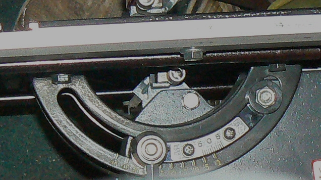

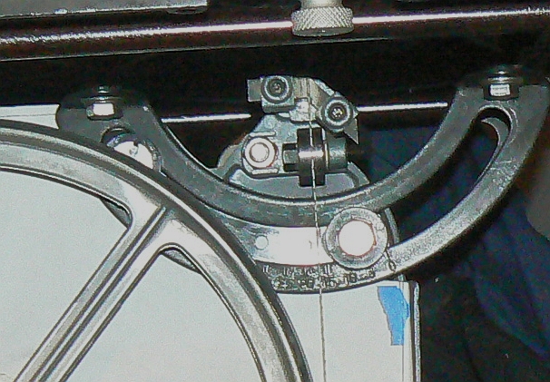

S Brian wrote:Quote from original post:
I cannot tighten the table tilt lock on my bandsaw. The 3/8" Table Clamp Bolt starts rotating before the tilt lock tightens. Upon taking everything apart, I see two split bushings that are pressed into the housing, which the table clamp bolts go through. Both bolts have small "wings" under the head, which fit into notches in the split bushings. I assume the "wings" are to keep the bolt from turning. When looking at the exploded view and the parts list, I do not see any part number for the split bushings. My split bushing is turning when I try to tighten the tilt lock. I have noted the position of the notches and I know it is rotating.
Below are the parts I received today from SS.
My bandsaw was built in 1985 with the cast iron table and the parts I was told that I needed were changed when the aluminum table was introduced. The new bushings are required because the plastic trunnion supports have projections on the back side that fit into the bushings. The associated washers, nuts and trunnions are the same for both designs.
What SS forgot is that the old bushings are .564 dia. x 2.37 long and the new bushings are .689 dia. x 1.93 long. So now my options are trying to glue the original bushing, to stop the rotation or drilling/reaming the holes in the housing to accept the new bushings, which according to SS are a slip fit not press fit.
The new design does not depend upon the bushings to prevent rotation of the hex head screw. The plastic part does that with the hex shaped 'hole'.
I have no explanation for the bushing od difference.
Here are a couple of pix which may help.
[ATTACH]24288[/ATTACH]
[ATTACH]24289[/ATTACH]
bs trunion l.jpg (255.08 KiB) Viewed 2694 times
bs trunion r.jpg (221.62 KiB) Viewed 2696 times

I understand that the plastic trunnion support is what prevents the bolt from turning, which you all agree with, but the plastic trunnion was introduced when SS changed from a cast iron table to the aluminum table. Behind the plastic parts and the steel trunnions are the two bushings. And as I stated when I started this post, the plastic pieces fit into the bushings. The problem is the new bushings have a larger O.D. and will not fit into my housing, which is for a cast iron table and the plastic pieces will not fit into the smaller bushings that are in my housing.

S Brian wrote:I understand that the plastic trunnion support is what prevents the bolt from turning, which you all agree with, but the plastic trunnion was introduced when SS changed from a cast iron table to the aluminum table. Behind the plastic parts and the steel trunnions are the two bushings. And as I stated when I started this post, the plastic pieces fit into the bushings. The problem is the new bushings have a larger O.D. and will not fit into my housing, which is for a cast iron table and the plastic pieces will not fit into the smaller bushings that are in my housing.
I think another call to CS is appropriate.
Since 'upgrading' from a CI table to the current is available, there has to be a set of parts(bushings) that will work.
