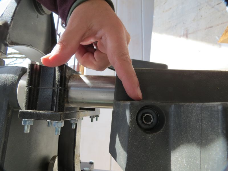

Take the tension off the lever and then tighten the nut on the other end. It will only take a small amount of a turn in most cases to fix it. Just make sure the lever can still be locked and that it doesn't require a gorilla to lock it. It might take several try's to get it just right but when you do the carriage should lock in place with no more slipping.
The nut is back inside so a socket will be required to reach it.
[ATTACH]24291[/ATTACH]
- IMG_1221sc.jpg (57.45 KiB) Viewed 2559 times
GEEZ I must be getting senile!:eek:reible wrote:I think you will find it only needs a small tweak of the adjusting nut to fix your problem.
How could I have over looked THAT!:o
