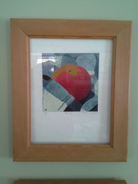

Here's an imperfect frame I did a while ago. You can especially see the imperfections in the top left and bottom right corners. There are small gaps toward the inside of the joints.
[ATTACH]24351[/ATTACH]
There was no trimming of parts, and I made no effort to fill in gaps. I just aligned the pieces as best I could and glued the joints.
My point is to show what's realistic without any special equipment. The cuts were done with the standard pistol-grip miter gauge. I took the trouble of aligning the miter gauge and the rest of my 510 according to the book. I used no special procedures, no digital tools, and no magical incantations. I was merely careful, and I got an acceptable product. Certainly not professional quality, but good enough for friends and family.
Better equipment will yield better results. And Jerm's picture probably deserves better than what I did. My skill level is middling at best. But, if you're careful, you just might surprise yourself.
