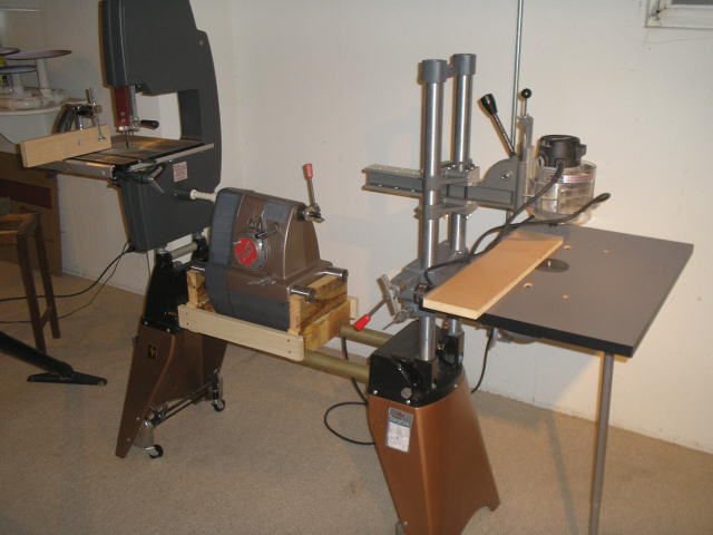

There's a few of us that have set up a Mini station for this. Here is my go-to place for routing and bandsawing:
[ATTACH]24424[/ATTACH]
Sanctuary Right Side.jpg (38.8 KiB) Viewed 3781 times

And a few more of us have this style....
Chucks in Phoenix Mark V(5), Mark VII(2),Power Pro, Planer, Crafter Station, Jointer,Bandsaw(3),Lathe Duplicator,Belt Sander,Jig Saw,DC3300(2),"Sears Router Crafter", Post Drill, Stand alone Overarm Router. Jointmatic ++++,

I like this. idea. Something else to do with that extra head stock.

I have a 'permanent' drill press setup (base tubes are super short, way tubes are normal length) and just move the headstock to the top and lock, then attach the pin router.
