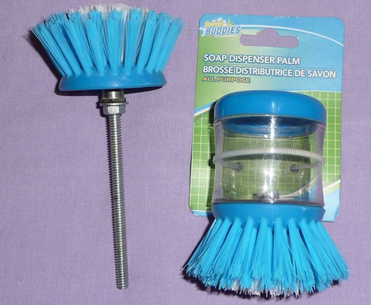

[ATTACH]24722[/ATTACH]
Got these for $1 each at Dollartree. Added a carriage bolt and nut and viola! Much cheaper and works as well. Pick up a can of Kleen King Aluminum Brightener (probably about $5 at ACE or a grocery store.) I still have half a container left from 1980. Price tag reads 50 cents.
- Brushes.jpg (82.91 KiB) Viewed 5242 times
Well, I tried the dollar store, no luck on any brush I could convert or cleaning agents. I did find x-large thick long gloves... Good timing there as I ripped my last pair and my hands get fried cleaning this stuff.
I'll pick up some nevrdull and brushes to try later this morning. I know the cheap round b brush won't have the abrasives embedded but I'll try them anyhow using abrasive polish as suggested.
