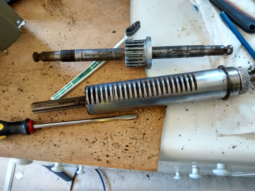

I'm tearing down and cleaning up the greenie I got for free with an 82. a few weeks ago. I cleaned and polished all of it except the headstock, then last night took the headstock all apart. I've got some questions about the quill and what to do with it...
On the Sawdust Sessions video about quill repair he said that if it was a single bearing quill a probe would nearly reach the far end before bottoming out. In my case a screwdriver reaches only about three inches into the quill tube before hitting what looks like a bearing, but there is way too much play, suggesting it is either A) not really a bearing B) no longer a bearing but a bunch of crunched up pieces. Seeing as this machine was very poorly cared for I doubt the previous owners spent money on oil, let alone an upgrade.
So first question: what am I hitting?

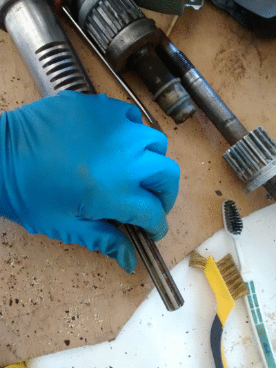

This shows ugly play in shaft. (Animated, so refresh if not showing, or you may have animations off. Only plays a few times so it doesn't drive you crazy)
Second question: I don't have access to a press. Can I take the quill shaft and drive shaft apart, and more importantly, get them back together? I've searched but haven't found anything.

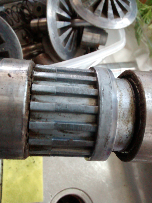

Last question: all the teeth throughout the machine look fine except the gilmer drive teeth on the idler. The gilmer belt was broken, which is why the last owner thought it was a total loss and included it for the price of removing it. The wear looks OK to me, but I wouldn't know:
[ATTACH]24774[/ATTACH]
I cleaned off the teeth a little but left the rest of the crud on. How do I clean it off without forcing dirt deeper? Guess that was the lastest last question.

Screwdriver tip shows how deep it goes inside tube

More than likely it's a single bearing quill on a gilmer drive SS. What your probably hitting is a washer that in a couple inches. I THINK Bill Mayo may have 2 bearing quills for a gilmer drive.

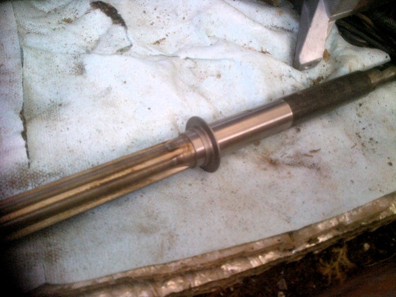

1. There is a spacer on the shaft just past the splines.
[ATTACH]24775[/ATTACH]

3. The teeth don't look that bad to me. Because the Gilmer drive can't slip if there is a jam (like the poly-v belt can) there is a clutch built into the drive. To disassemble the clutch you will neet a bearing separator/puller. Mickyd also did thread on that topic.
Gilmer Drive System - Cleaning, inspecting, testing.
4.Easy to clean when it is disassembled

That makes more sense, it being a washer. I can't imagine that much play even in a broken bearing, nor the previous owner(s) having invested in such. It does look like a bearing from what I can see - under the dirt there are concentric rings like a bearing would have, so I had to wonder when it was where the video said a second bearing is.
Now, how do I clean it up? Do I disassemble it? Can I do so without a press? If not, how do I clean it without drying out the bearings or forcing gunk into them?

You are attacking the quill problem from the wrong end. Take an awl or sharp pointed knife, remove the putty from the aluminum collar which will expose a allen head set screw. Take your 5/32" allen wrench and remove the set screw. Take the aluminum collar off. You will need to remove the retainer snap ring. Put a board on the spline end and drive the spline shaft out the other end with a hammer. The bearing will come out with the shaft.

You don't need a press if you have a bench vise. After a new bearing is installed on the quill shaft, it can be bumped back into the quill with little effort using a deep well socket so you are bumping the inner race of the bearing. A short piece of black pipe works OK too. Be sure you are bumping the inner race otherwise you can damage the bearing.
By the way the quill on the MK V is not made like the quill on a 10ER like the video referred to. The splined shaft comes out of the quill from the table end after you remove the snap ring and goes back in reverse.
