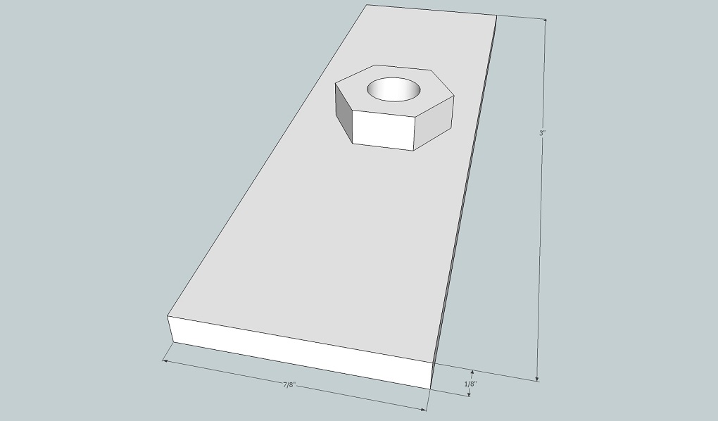

I bought some flat steel bar (7/8 by 1/8) and nuts (3/8 -16 and 1/4 - 20) with a plan to make my own.
[ATTACH]24998[/ATTACH]
Too many other irons in the fire. however in the next two weeks will build some to see if this design is feasible. Was planning on epoxy to hold the nuts but may tack weld. JPG suggested tapping the metal bar rather than just drilling a through hole, so I may try that to give some extra security. Cost not including "old fart" labor, about 70 cents each (that includes shipping of the bars and gas to get the nuts).
I would guess that the wooden ones were even cheaper!
