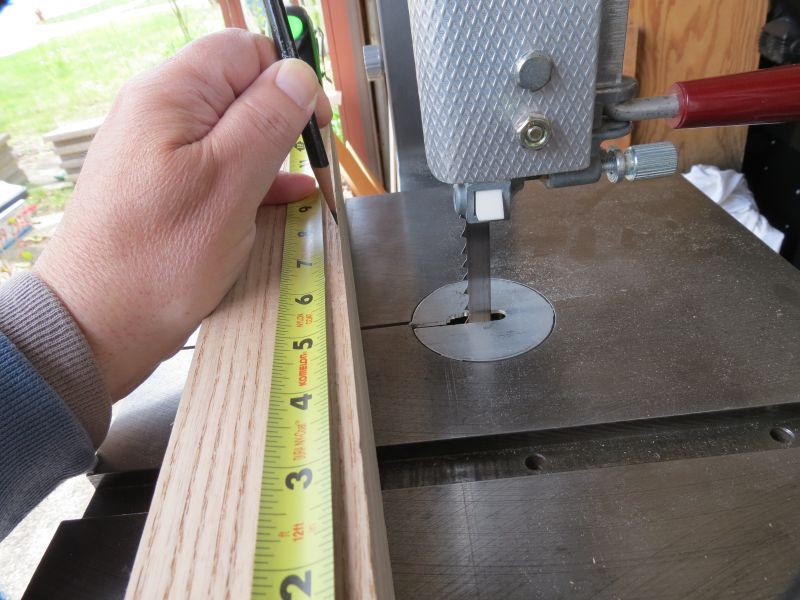

In my case I was going to cut this piece of ash in half. Using a ruler and pencil I simply make a small mark.
[ATTACH]24911[/ATTACH]

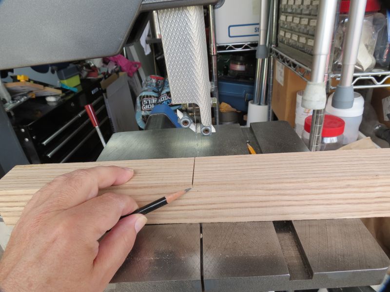

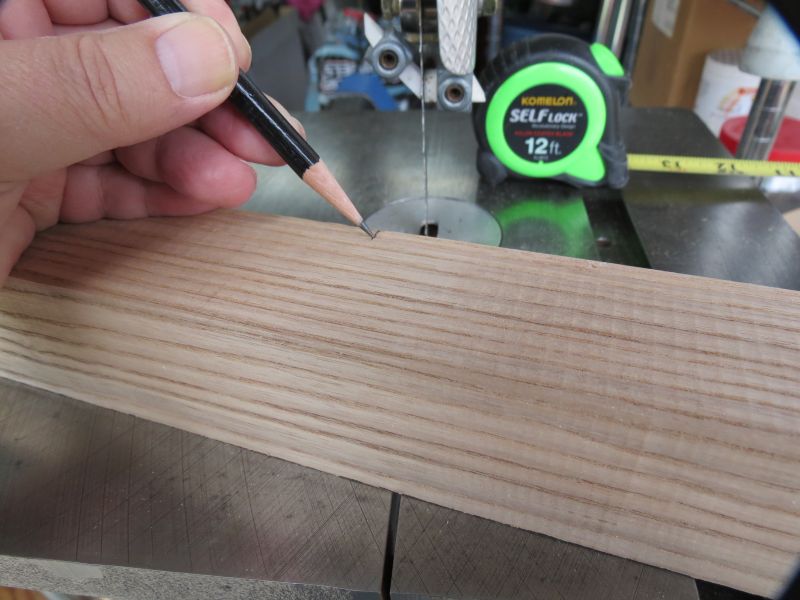

Using this mark as a guide you next touch the wood to the running blade at that mark like you were going to make the cut.
[ATTACH]24912[/ATTACH]
Now when you rotate the stock towards you, wallah you have a line to follow! How cool is that?
[ATTACH]24913[/ATTACH]

Hi,
Sorry if you missed the point, or my explanation of the tip.
Wood size is pretty much not relevant so long as you have an edge to stand it on and the wood still fits the bandsaw. You could do a 1 x 6, 2 x 4, 6 x 6 or just about anything between.
The small line you draw could be about anywhere on the board, hey even near an end for squaring up the end. Where ever the line is you have to be able to see it and align it to the blade before making the kerf. The point being the kerf becomes the line you follow.
Perhaps a few minutes out in the shop with a piece of wood and the bandsaw will help you see the light.
If you are still confused let me know and I take more pictures and add more words until it is clear.
This is one of those tips you can use to impress your shop buddies. Almost painfully simple but still so cool.
