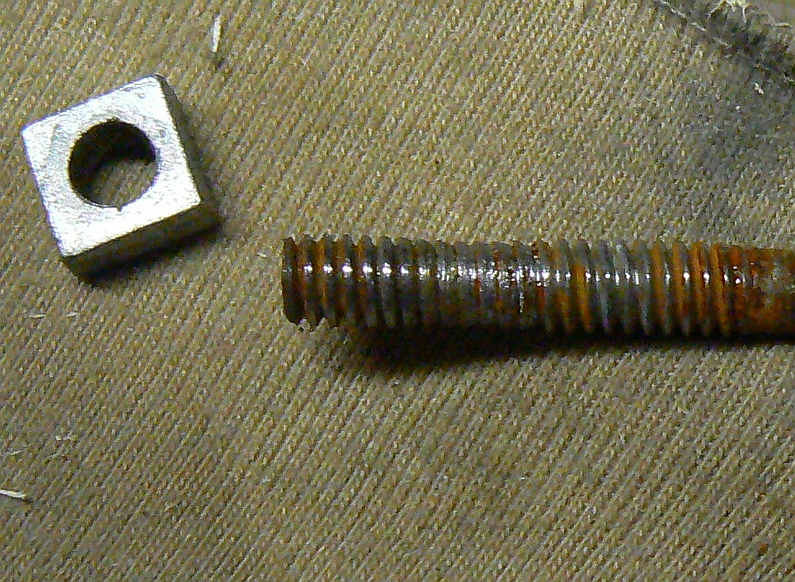

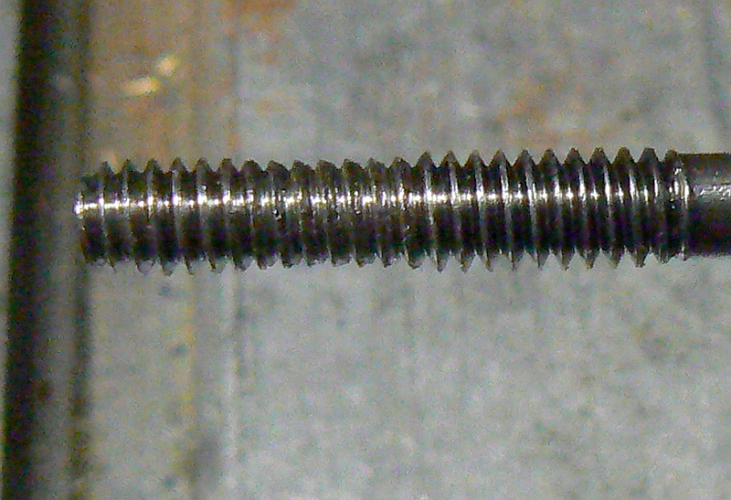

And here is a major problem and it's cause. The clamping screw used a square nut. Both the nut and the rod are smushed.
[ATTACH]24915[/ATTACH]
After chasing the rod threads it looks much better and salvageable.

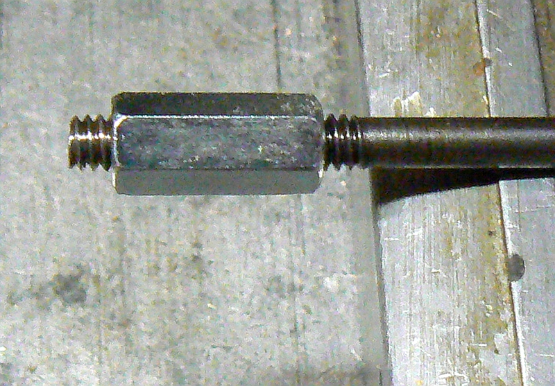

This will replace the nut to prevent the funky threads from doing a repeat performance.

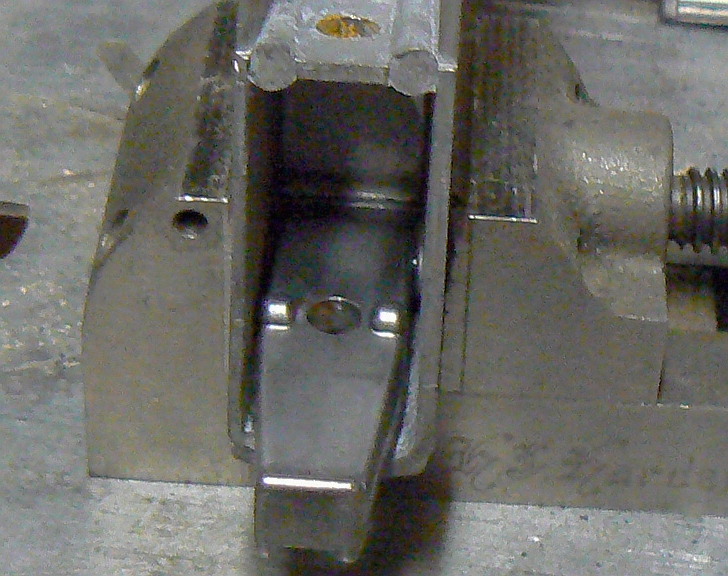

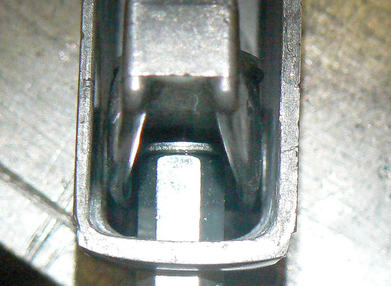

Step one of reassembly is to start the front clamp tension pin. Take care to not let it protrude into the inside cavity(the clamp is a snug fit side to side).
[ATTACH]24919[/ATTACH]

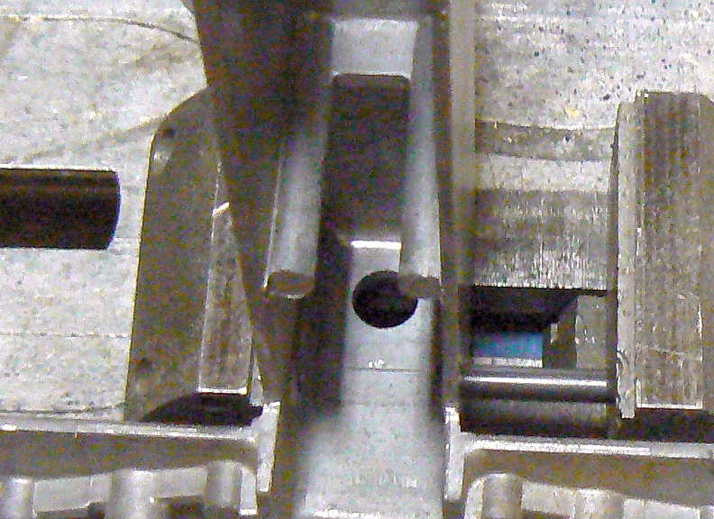

Here you see the tension pin coming through the front clamp.
[ATTACH]24922[/ATTACH]

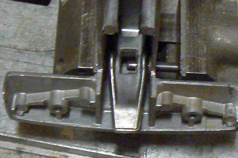

That was so much fun, we do it again for the rear clamp
[ATTACH]24923[/ATTACH]

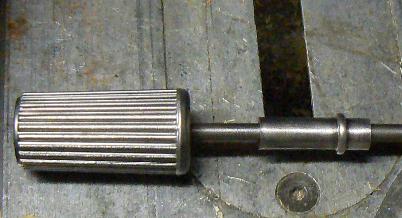

Now for reassembling the clamping rod etc. Step one slip the sleeve on the rod. Notice the orientation. This sleeve presses against the front clamp(through a washer).
[ATTACH]24924[/ATTACH]

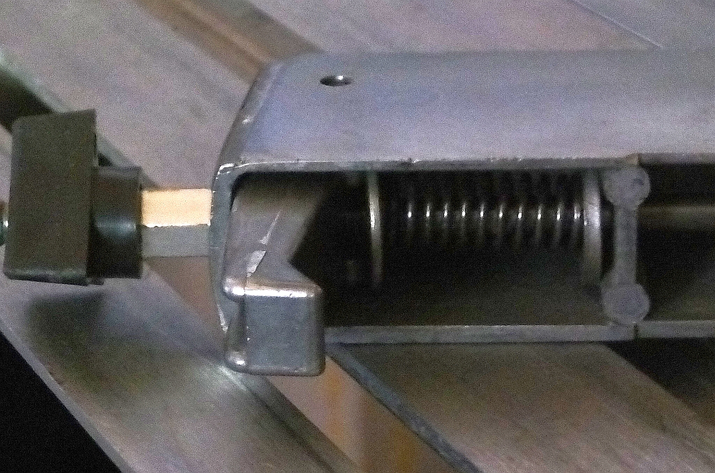

Front spring bounded by two more washers. This spring is weaker than the rear one so that the front clamp moves first.
[ATTACH]24926[/ATTACH]

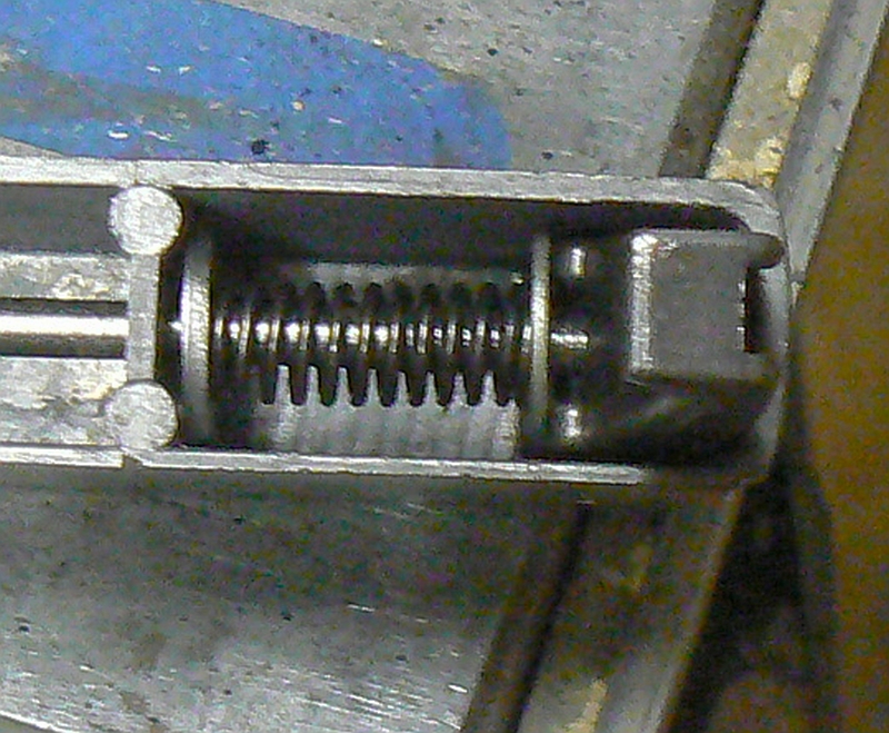

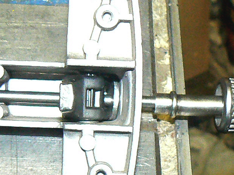

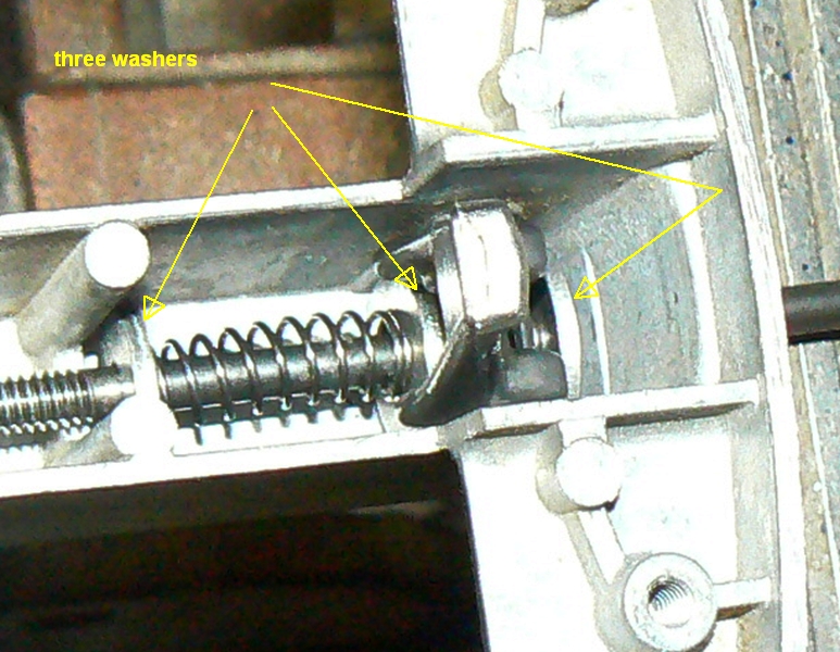

Moving on to the rear. I dropped one of the original washers(all 5 are identical) so I had to insert a furrin one until the original comes up fer air.
[ATTACH]24927[/ATTACH]

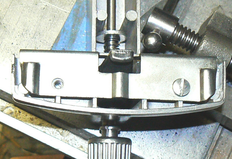

I added a flat washer between the rear clamp and the coupling nut since it is smaller that the original square nut. I will add a better pix of this at the end.
[ATTACH]24928[/ATTACH]

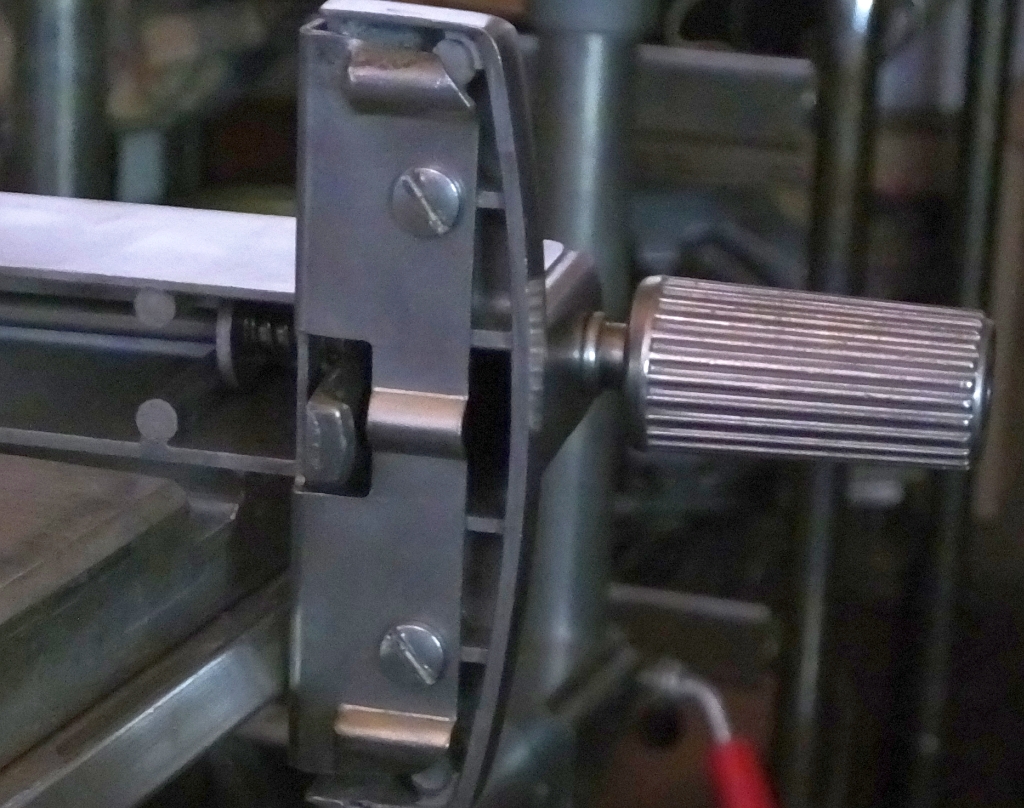

Adjustment for squaring the fence is flimsey at best IMHO. These screws were really really tightened when I took them out. I think that indicates holding square might be a problem. There is limited adjustment possible with the unique table front rail mounting.
[ATTACH]24929[/ATTACH]

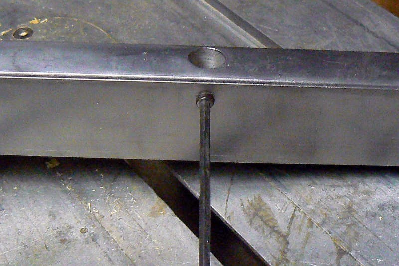

Last the mortising hole screw is inserted.
[ATTACH]24930[/ATTACH]

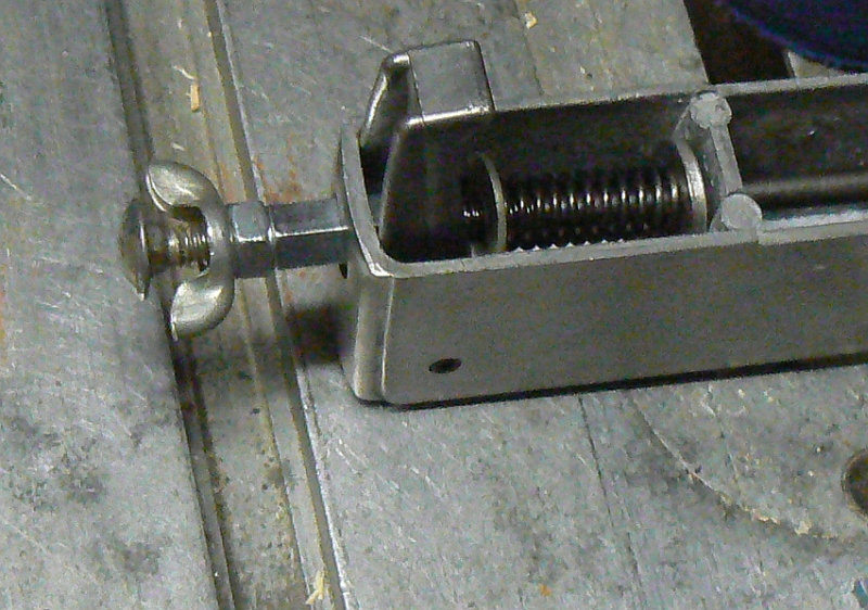

Since the coupling nut can rotate(it doesn't until really torqueing the clamp screw handle), I added this crude pile of miscellaneous hardware until I come up with something better(like a knob etc.).
[ATTACH]24931[/ATTACH]

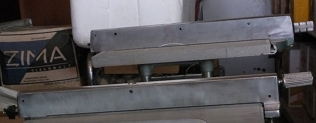

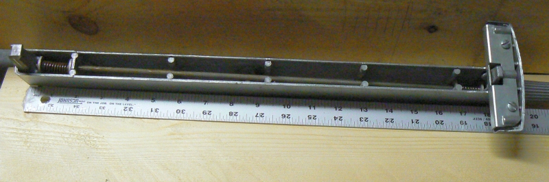

So here it is next to it's smallest bigger brother(a Mark 5 rip fence).
[ATTACH]24936[/ATTACH]
I will add a better pix of the added washer here after taking one. The washer needed to be filed on two sides(double d shape) so as to fit in the rear clamp cavity where the original square nut fit.

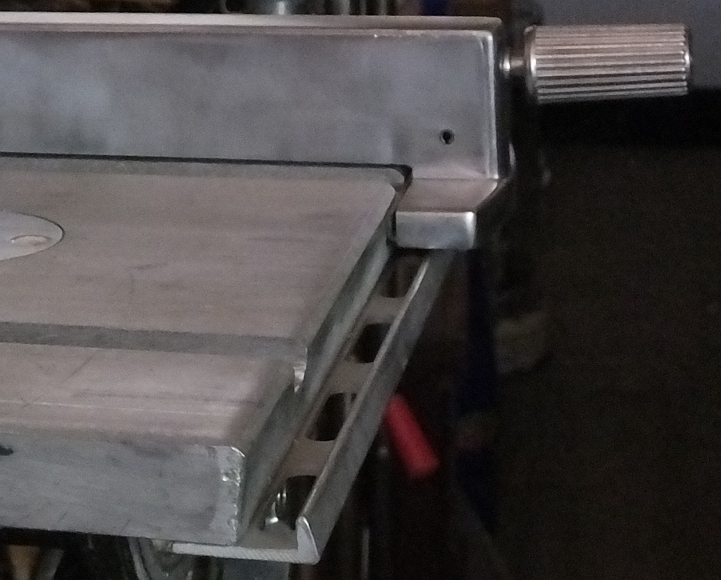

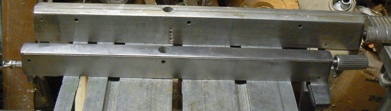

Also I will add pix of the Mark 2 table showing how it varies from a Mark 5/V table.
Notice the different shape of the front fence mount rail.
[ATTACH]26249[/ATTACH]
The small ridges are what registers against the front rail(only the two outer ones).
[ATTACH]26250[/ATTACH]
The rear clamp now has spiffier knob. The knob is not actually functional for normal use. It does allow manually preventing the coupling nut from rotating if needed.
[ATTACH]26251[/ATTACH]

Here you can see the M2 clamp shaft slopes downward towards the rear. The Mark 5 rod is horizontal.
