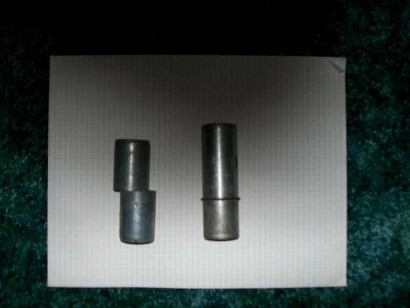

I have a goldie SS jointer, on my greenie jointer mounting tubes there is a "ring" on each tube to set the height on it to help it align to the HS PTO for the jointer.
I went to the parts list, which I am assuming is for the newest version, since they show the tubes as "off set" tubes. Are those rings still available from SS? If not alternative ideas? Otherwise I will have to use my limited brain power to think of an alternative myself.

You should be able to get those rings from Mcmaster-Carr
http://www.mcmaster.com/#shaft-collars/=ryot7n
The ring is what stops the tube downward movement in the headrest or base arm. I sometimes have to cut the upper end of the tube to allow the SPT shaft to align up with the headstock shaft. There is a later version with an offset that works better. I sometimes have to loosen the tube lock bar bolts and twist the leg to get the shafts to align horizontally.rbursek wrote:I have a goldie SS jointer, on my greenie jointer mounting tubes there is a "ring" on each tube to set the height on it to help it align to the HS PTO for the jointer.
Thanks, Bob
- 100_0866.JPG (82.89 KiB) Viewed 1469 times

I think I know what he's talking about.
The old style stop collars. I have them on my lathe tailstocks, my joiner and my bandsaw. (I don't have the eccentric SPT tubes)
Item 291 in this diagram
http://www.shopsmith.com/ownersite/partscat/tailstockexpview.htm
291
501438
Tube Collar Assembly
$6.53

They are a split retaining ring like(but smaller) the main(upper) shaft bearing retaining rings. They are about 1 mm thick(two layers)(.042") and have an id of about 30 mm(1.18") and an od of 1.34". The groove in the mounting post is about 1.19" od.
