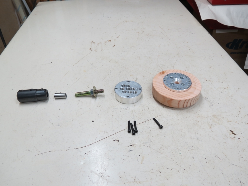

[ATTACH]25069[/ATTACH]
This is the collection of parts.

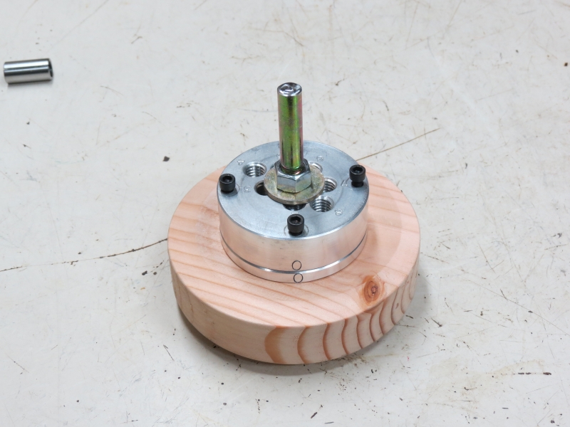

[ATTACH]25070[/ATTACH]
When assembled it looks like this. Note the "0" and "0" are lined up.

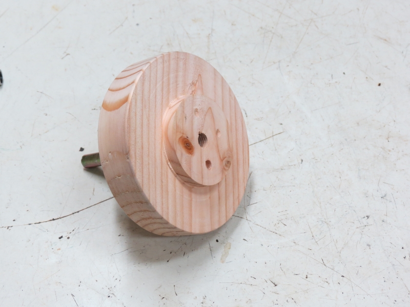

This is where I trued up the block and have it ready to mount the pendant.
[ATTACH]25071[/ATTACH]
This show the front or working face.

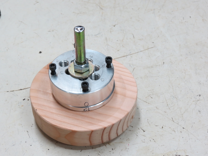

[ATTACH]25072[/ATTACH]
The pieces have been rotated 180 degrees.

In all three videos the base plate(attached to the drive screw/shaft) wobbles.
If you are truing the mount block with the secondary plate set to '0', then when set to 180, the wobble of the base plate will be doubled since the mounting block was 'trued' to a wobbling base plate. The greater od of the mounting block will increase apparent wobble further.
Measure the od of the screw and the id and od of the sleeve.
I believe all the wobble is due to runout between the 1/2" router adapter and the base plate. A bent screw would be culpable as well.

Ed, I assume you initially trued the block with it attached to the faceplate and the faceplate aligned 0/0. I further assume that if you return to that setup, the vibration goes back to normal.
If that is the case, it seems to me that somehoe the black simply gets off center to the faceplate.

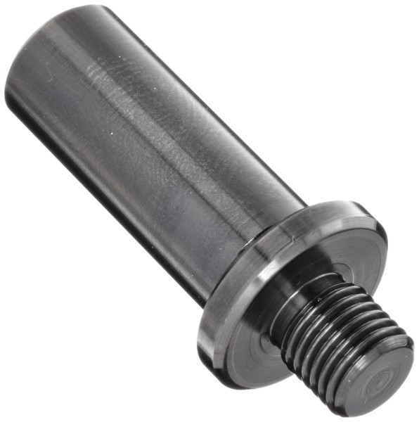

I would be suspicious of the 3/8 stud/washer/nut/adapter assembly. A one piece machined arbor would be a better way to go.
Tapmatic 1/2" Straight Shank Arbor with Threaded Mount, 3/8"-24 Thread

BINGO!!!!!!!!!!!!rpd wrote:I would be suspicious of the 3/8 stud/washer/nut/adapter assembly. A one piece machined arbor would be a better way to go.
[ATTACH]25074[/ATTACH]
