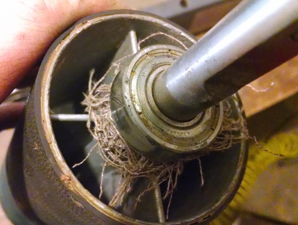

Both drive drum bearings will need replacement. For now I doused them in Ultra Lube after which bearing noise and mobility improved dramatically. It took awhile to pick out the strands of belt that had tightly wrapped up on both sides. I suspect that material may have contributed to bearing failure...

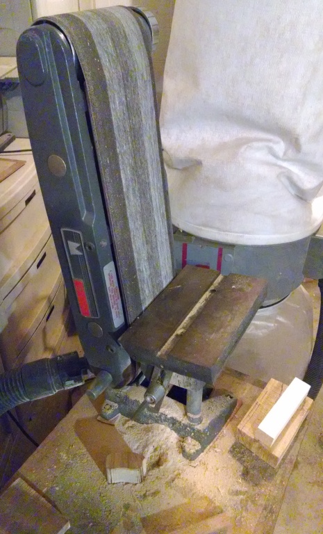

When I put the parts back together I had some trouble getting the belt tension right, but this PDF file provided the solution.
My son and I enjoyed testing it out. It could use the dust retro-fit upgrade but we're looking forward to putting this back in service just as it is.
[ATTACH]25342[/ATTACH]

With that much 'string' around the gearing, the belt was likely rubbing against the wear clips on that side. Do check that out and replace them if needed.
The clips are actually tinnerman clips.
