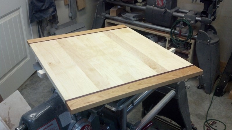

Hopefully I'm not duplicating this. My internet has been acting odd lately. I managed to finish my co-workers cutting board between storms, power outages, vacation and a ton of other distractions. Cherry ends, purple heart strip and maple field. One major problem, can you spot it?
[ATTACH]26099[/ATTACH]
- Cutting Board.jpg (88.66 KiB) Viewed 2184 times
