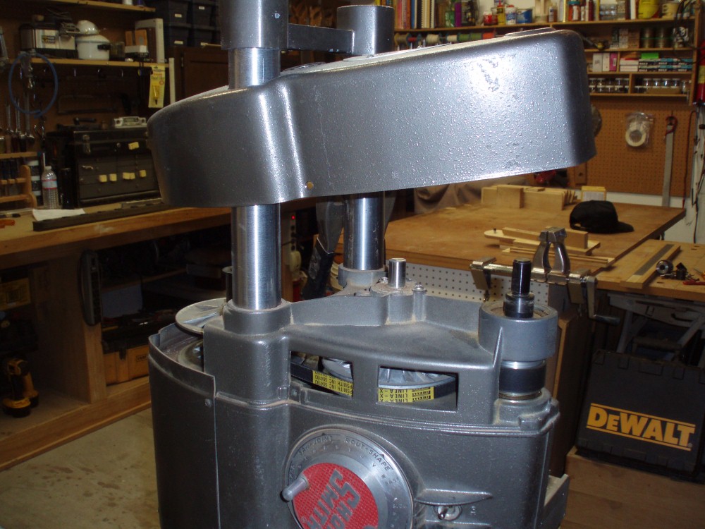

JohnSWA wrote:Ok, after my response, the belt on the motor side is rediculously loose. I followed through with the directions for the r/r even though I'm not replacing the belt since it's not showing any signs of wear. I'd love to figure out a way to tighten up the belt where the blade turns!
At what speed is your Mark V speed control currently set?
The v belt will likely be referred to as the drive belt or motor belt. There is nothing you can do to "adjust" the tension of this belt. The belt is tensioned by the combined actions of the two sets of sheaves. The sheaves function together as a variable pulley set.
You change speed by using the speed dial which in turn changes the the upper sheave.
It appears that with your problem the upper sheave might not be turning at all. The belt is apparently so loose that the upper shaft is not turning. Given this condition, I suggest that you DO NOT change the speed dial until that situation is changed. Attempting to change the speed dial without the upper shaft turning can cause damage to the speed control.
If you a need to change the speed dial, you can safely do so by manually turning that upper shaft. This is most easily done (my opinion) by mounting a sanding disk on the upper shaft and then use it to turn the upper shaft. With the upper shaft continuously turning, you can then change the speed dial.

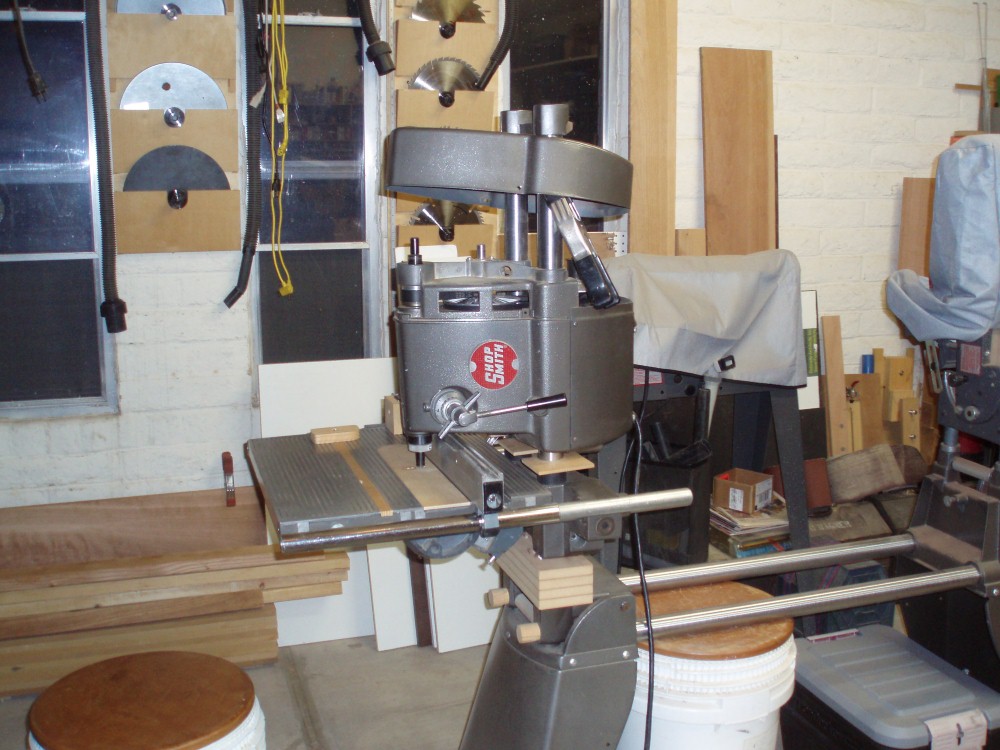

To work on this, I recommend that you put the Mark V in drill press mode and open it up as shown here.
[ATTACH]25861[/ATTACH]
[ATTACH]25862[/ATTACH]
- Positioned for Easy Access (Custom).jpg (180.92 KiB) Viewed 1270 times
- Sheaves at Low Speed 002 (Custom).jpg (192.2 KiB) Viewed 1268 times
