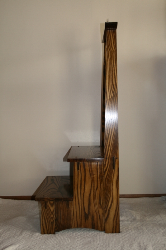

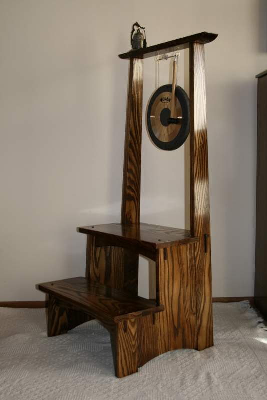

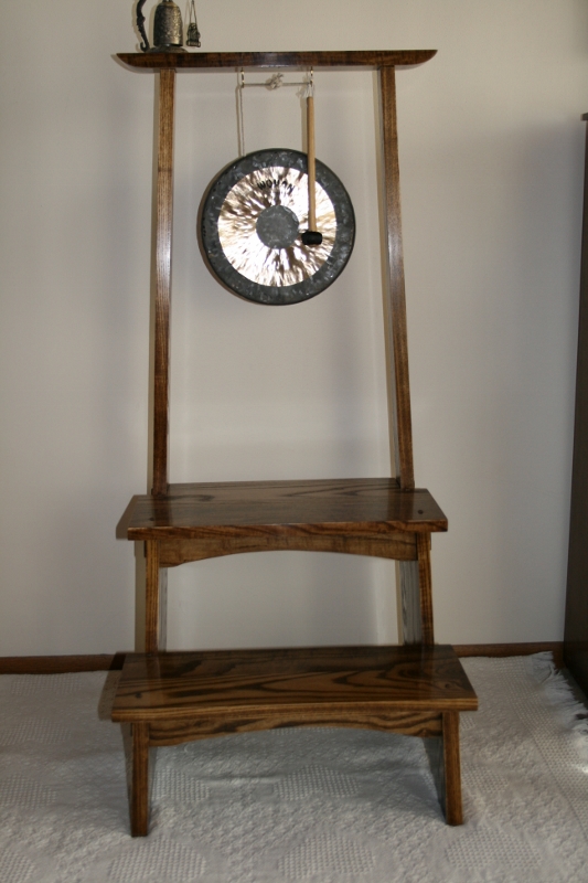

Wipped it out this week!!
- "Wild Bad Bob"
- Posts: 1065
- Location: Germantown, Wi
I needed a step stool and a gong holder for the 5 O Clock Hour!;)
The goal here was the 2.5* angle on the construction, side and back. We can all make something, the key is to be unique, in wood, style, joinery, ect!!!
- IMG_6184 (533x800).jpg (278.92 KiB) Viewed 2363 times
- IMG_6185 (533x800).jpg (279.49 KiB) Viewed 2324 times
- IMG_6186 (533x800).jpg (252.79 KiB) Viewed 2314 times

So with out a separate post, what kinda wood is it????

You almost won!!! BD, Yes Ash, first dyed, with medium brown, then a wash coat of 1 1/2 cut Shellac, then buff with maroon pad, then stained with dark walnut, then 3 coasts of oil poly.BuckeyeDennis wrote:I'm going to guess that it's ash. With a base coat of stain, then sealer, and then the grain highlighted with a darker stain that stays down in the pores.
Dye first for color, then wash coat to seal the wood but not the pores, oil/pignant stain to fill the pours for depth and other color of choice/compliment!!!

I Love Ash first 2.15 a Brd Ft at my supplier, can be totally white or a nice tannish. machines nicely, strong, closed pored.
