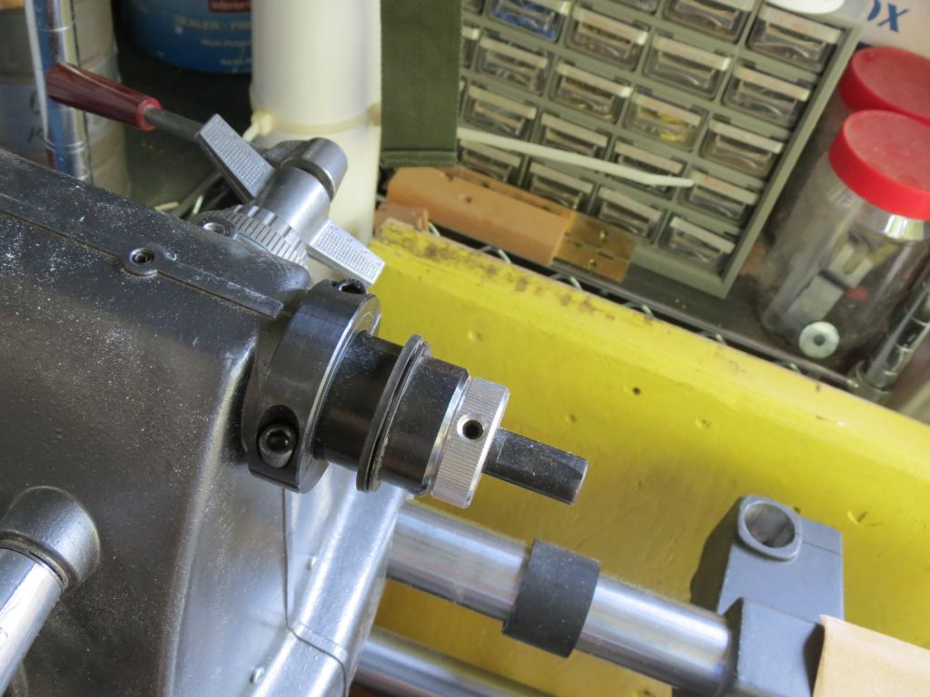

Place the blade of a feeler gauge between the rubber bumper on the quill and the headstock.
algale wrote:Place the blade of a feeler gauge between the rubber bumper on the quill and the headstock.

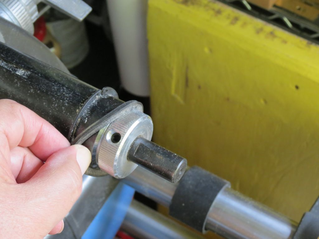

This can be done but it is really easy to remove the rubber bumper and it would be a lot better to measure metal to metal.
[ATTACH]26148[/ATTACH]
However the adjustment there would not be my first choice. Please see my next post to see what I do.

I have complained about this issue before, this is one of the reasons a shopsmith is not a good router table.
I've shown several solutions to fix other issues and may or may not have shown this before. I did a pretty big post about stop collars and I really can't remember if this was included, I've also posted about router usage so it could also or instead be in those posts.

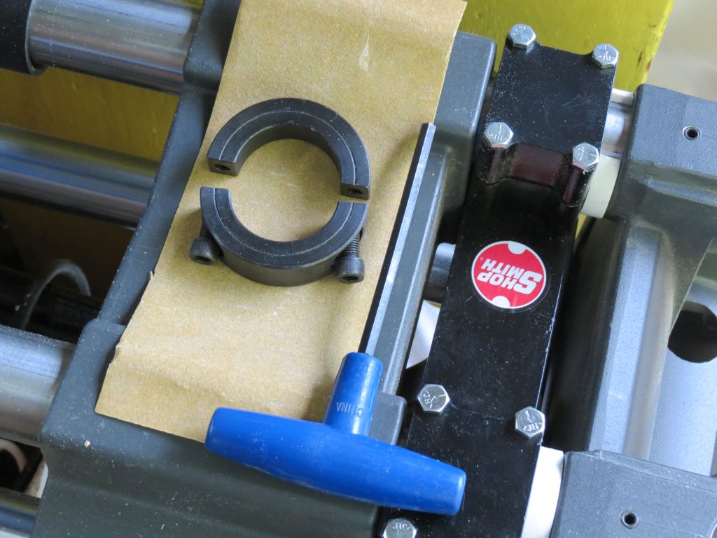

I have a split collar which makes it easy to take on or off. You can always pull the quill and use a standard stop collar but for the few bucks you save I've gone this route.
[ATTACH]26149[/ATTACH]

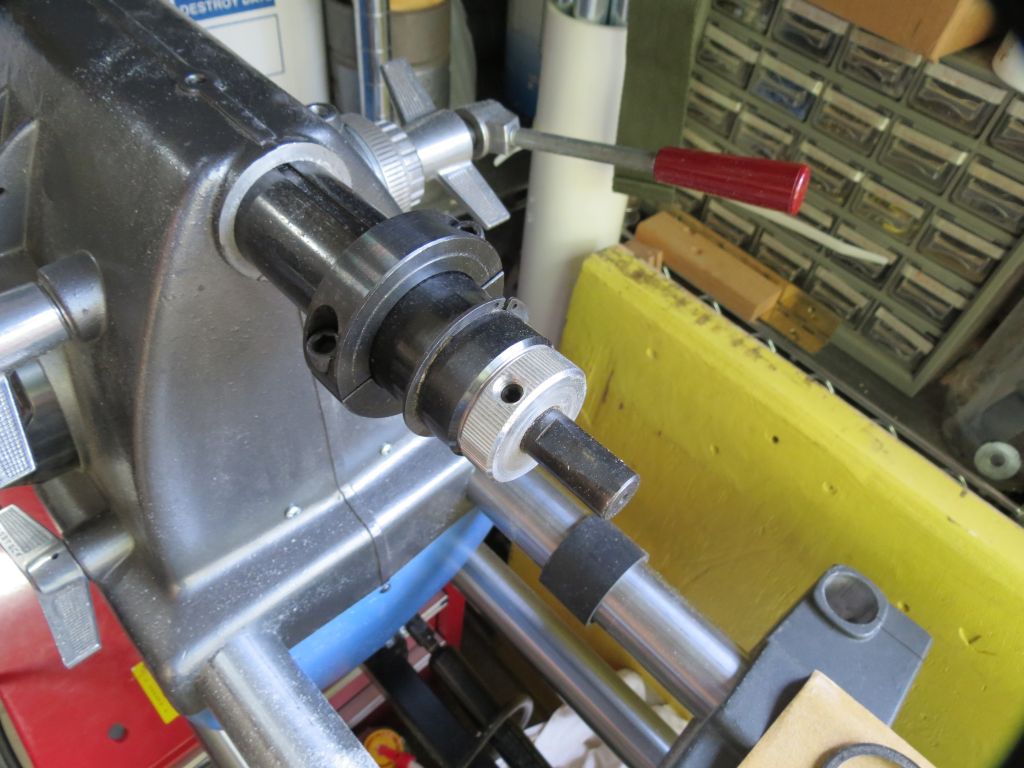

I extend the quill and lock it in place. The stop collar is then attached, making sure it is tight enough to not move yet no so tight that it damages anything.
[ATTACH]26150[/ATTACH]
[ATTACH]26151[/ATTACH]
Now when you loosen the quill it will stay at that point where the stop is. I use that as the starting point for adjustments. I use the quill to move close to the height trying to stay just a little short. Then adjust the collar when I am with in feeler gauge range. With the collar locked I can then move the quill up by the thickness of feeler gauge I need. Move the collar up again to lock it in place along with the quill lock.
The lock can be used for other quill features so feel free to play with other projects and settings.
Is this a perfect solution? No not even close. Well unless you love working under the table a lot. Works better from above but then that too is not a perfect routing solution.
