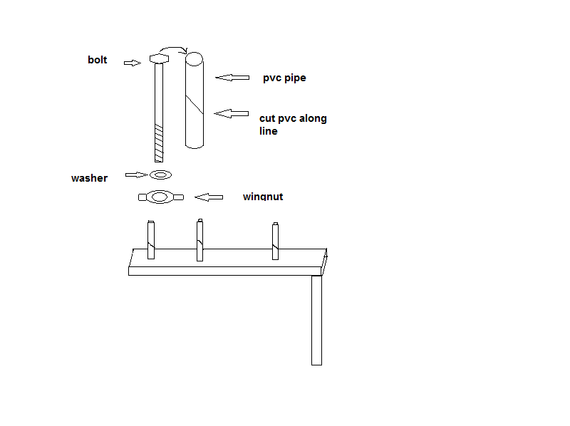

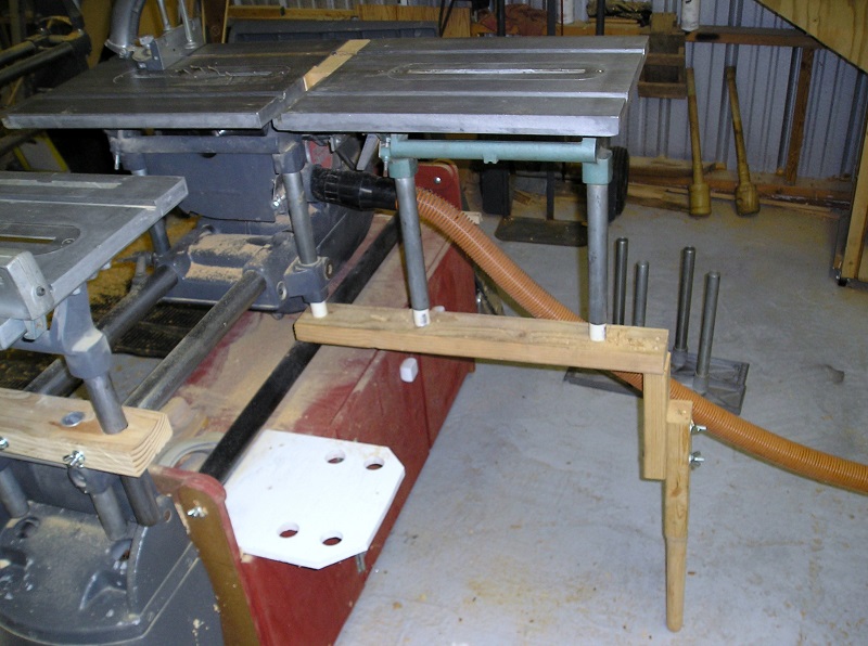

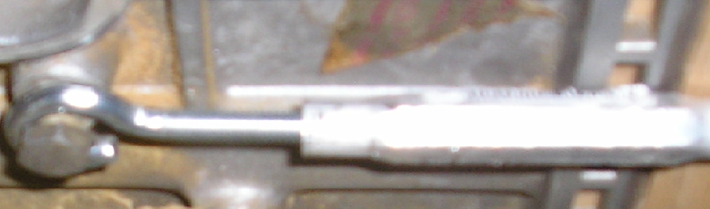

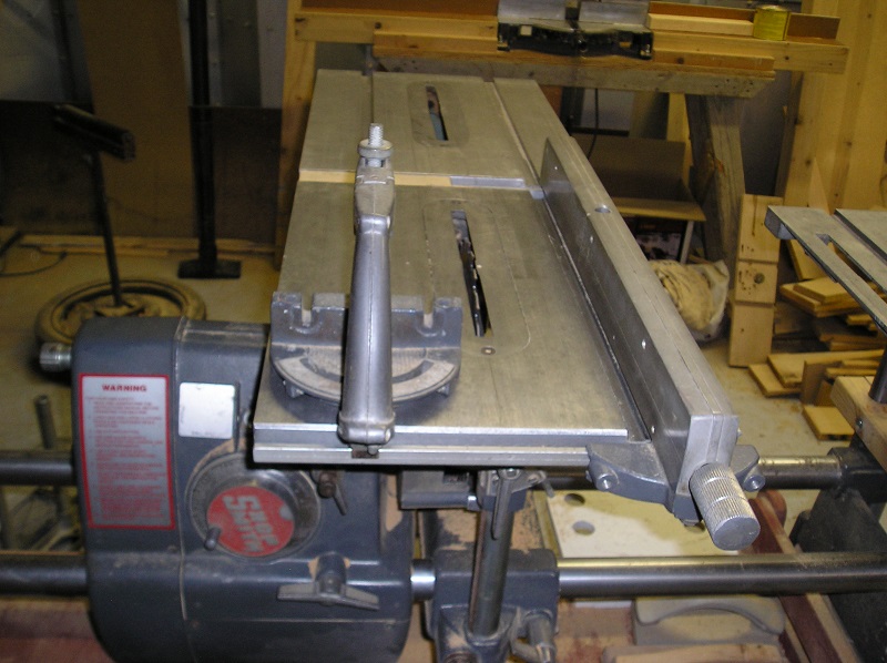

[ATTACH]26161[/ATTACH][ATTACH]26159[/ATTACH] Here is what I did. it worked well for me , hope it will help[ATTACH]26160[/ATTACH].[ATTACH]26158[/ATTACH] I didn't post this very good but I hope it gives you the idea. ;)
