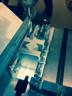

I was never very happy with my standard drill press when it came to centering the bit on the blank. With the Shopsmith in drill press mode, it's a snap. Just set your fence and lock the miter gage in the slot and you have a perfect way to place your pen vice where it needs to be!
- image.jpg (33.33 KiB) Viewed 5419 times

I use the boring method. I made a jig out of some spare mdf to hold in in place and drill away. Then it's a quick table removal, switch from drill Chuck to pen mandrel and I'm all set. I'm still working out details of the jig as I go along, but it's working great.
I also made a jig to use horizontally. I cut a v-groove in a piece of scrap, attached a hold-down clamp, and voila. With the V, after I get the jig positioned and clamped to the table, I only need to adjust the table vertically if I'm drilling different sizes.

With my setup, I never have to move the table. The vice that sits on the table is a self centering pen blank vice. I think I picked it up at woodcraft or Penn State Industries. Never fails! For repeat set ups, I have simply traced where to place the fence and miter bar with a fine tipped sharpie.roy_okc wrote:I also made a jig to use horizontally. I cut a v-groove in a piece of scrap, attached a hold-down clamp, and voila. With the V, after I get the jig positioned and clamped to the table, I only need to adjust the table vertically if I'm drilling different sizes.
I should also note that this Mark V is almost always set up as a drill press. I do my turning on a different machine.
