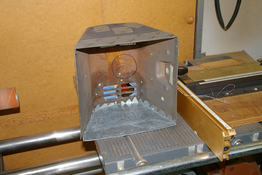

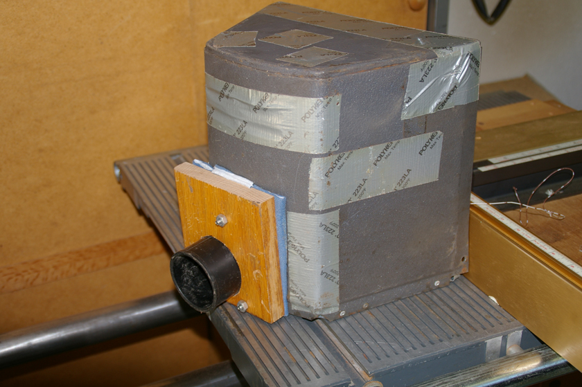

I couldn't get a couple of bucks or no takers for a "Freebie" so I decided to put this old Mark VII motor pan to some good use. I have always just cleaned up the mess after using the drum sander but maybe this will catch some of it. I haven't tried it yet, I need to make some more refinements. The unit fits great just laying on the way tubes. It's heavy enough that it doesn't move.

Since your SS won't reverse (I assume you haven't re-wired it) most of your dust is going to go down and towards the back. You might try closing off the front portion a bit to increase airflow down the back side. Trial and error works every time.

You are probably right about the air flow. I thought about making a partition but wanted to see how it works before going to the trouble.
I wanted to close all the openings with something other than duct tape but will need to think about it a little.

I had an attachment like yours for my shop vac at one time. I haven't seen it in about 25 years. It may still be here somewhere but senility has set in. I dug this motor pan out of the trash twice thinking there just has to be a use for it somehow. I am thinking about using a cut-off disk and cutting the front down. I just tried the drum sander and it works great but seem to be a little confining on the front. We will see!!!
