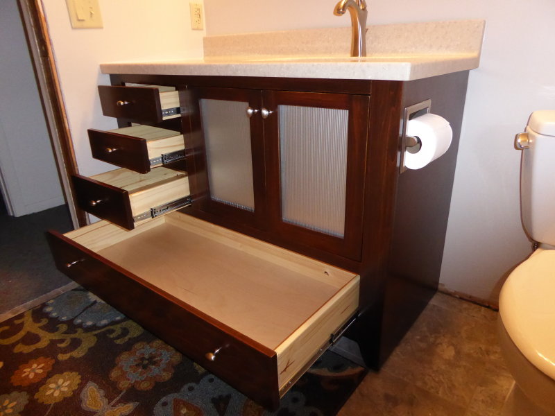

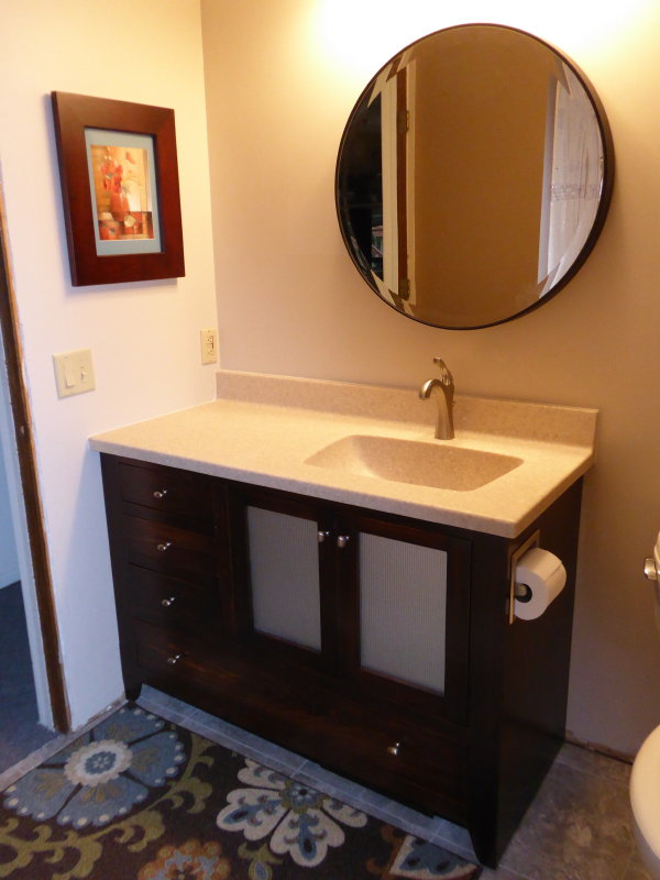

There were three overriding factors for design. First while we are re-doing the bathroom we are keeping all the walls and not moving any plumbing. So that pretty much dictates the overall size, although we did raise the height 2.5” Second, we wanted a more ‘modern’ look/feel. Finally we wanted to get the most storage space in the vanity.
I’ve always thought that vanities don’t make good use of space. The best idea I could come up with to improve things was a large bottom drawer, the full width of the cabinet. This cuts down on the ‘cabinet space where the plumbing is but I never seem to use that space well.

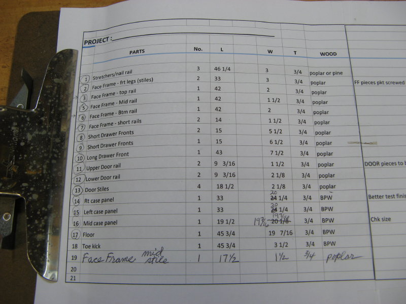

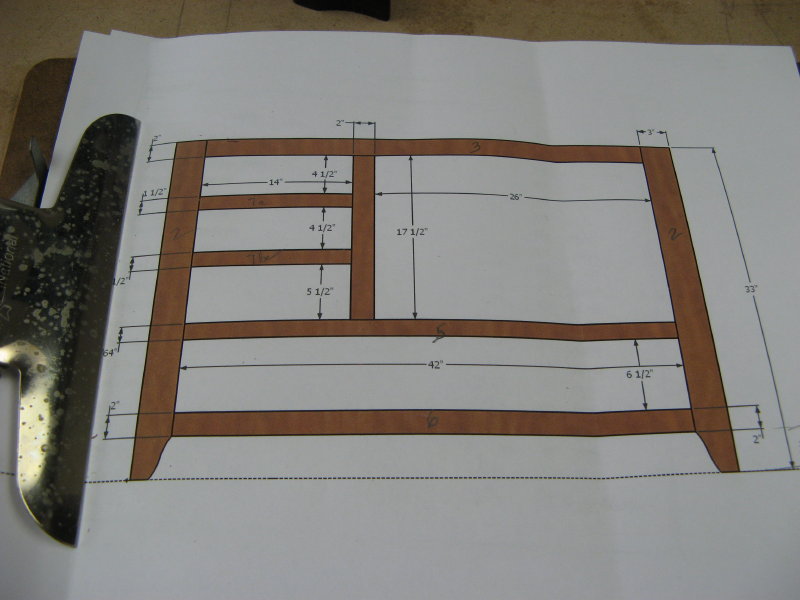

I use Trimble SketchUp (aka Google SketchUp) for design work. Here is the drawing for the face frame. From the SketchUp work I made my cut list.
[ATTACH]26447[/ATTACH] [ATTACH]26457[/ATTACH]
WOOD – I decided on poplar for the face frame and drawer fronts. My local HD has a good selection of poplar and it’s priced fairly. For the case pieces I’m using ¾ birch veneer core. For the drawers Home Deport sells a 5/8” pine-like wood from Brazil. Finally, ¾” pine for the stretchers.

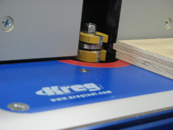

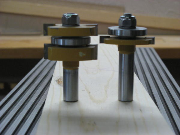

I think cutting the tongues and grooves is worth talking about. All the cuts are made on a router table. There are two key elements. First, cutters for the tongue and groove are a matched set.
Second, the cutters come with a rubber grommet. The grommet slides down to the bottom of the collet and the shank of the cutter rests on the grommet, when the collet nut is tightened the grommet compresses a bit. The grommet allows for the two cutters to be switched back and forth, and this is the key, without adjusting the height of the router.

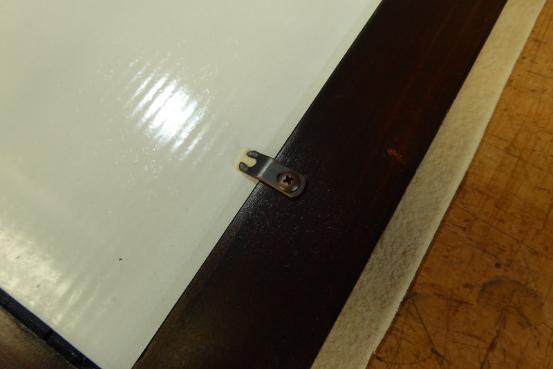

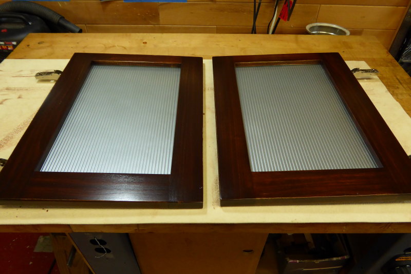

To add a little ‘bling’ to the project and help the dark stain stand out some I went with glass door inserts instead of wood. I had the shop cut reeded glass to size and then I painted the back of the glass first with silver paint and then white. I used little clippy things to hold the glass in place.
[ATTACH]26448[/ATTACH] [ATTACH]26449[/ATTACH]

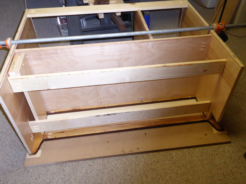

Here is a picture of the back and bottom of the cabinet. Missing from the picture is the 1/4' back panel that slides into place in the grooves on the case sides. You can see the stretchers, below the large drawer. On the left (of the picture) is a false cabinet side. I added this because I prefer to have the drawer slides mounted flush with the face frames.
The gap from the floor to the stretchers is to allow for the HVAC vent.

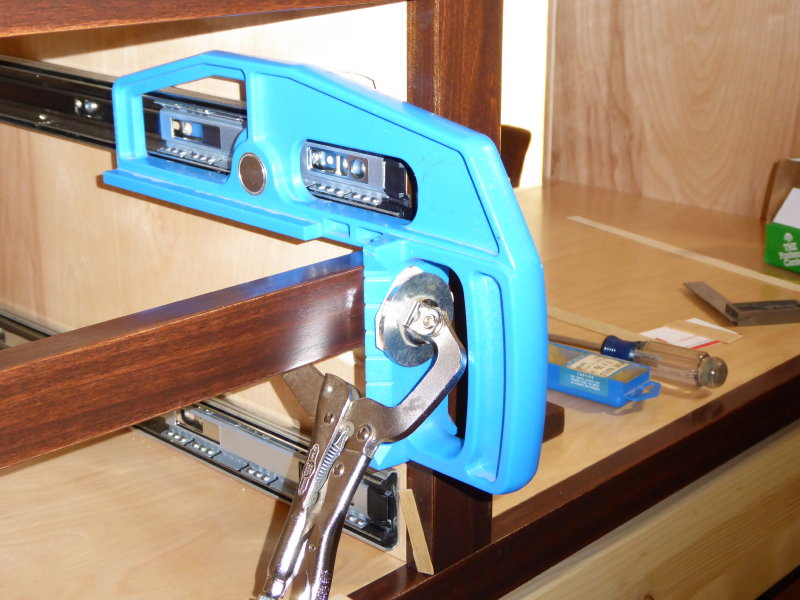

I use these Kreg jigs to install drawer slides. I find the very useful for either insert drawers or drawers where the face overlaps the face frame.
[ATTACH]26451[/ATTACH]

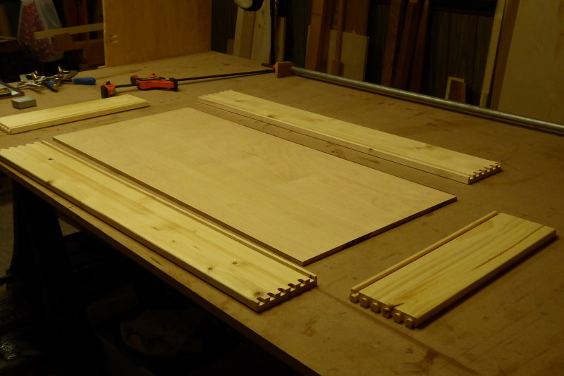

Here is the large drawer before glue-up.
[ATTACH]26452[/ATTACH]
[ATTACH]26453[/ATTACH]

First, the bits are made by an Italian company called CMT. You can find the at Amazon.
I bought them from Sommerfeld Tools for Wood. I think he's located in Iowa, or at least he used to be. I first heard about Marc Sommerfeld from someone at another forum. I purchased his video on cabinet building and the T&G set. An overview of "his system" is on YouTube. Here's a link: https://www.youtube.com/watch?v=klv0jzWD26w
I think he's hard to listen to but IMHO this system really works. Building cabinets is a snap. They are strong, square and easy to assemble. I don't work for this guy but think his system works and his products, at least the router bits are first rate.
Here is the set I got several years ago and cutting a tongue for the vanity a few weeks ago.
[ATTACH]26460[/ATTACH]
[ATTACH]26461[/ATTACH]
Hope this helps. If there is anymore I can add, let me know.
