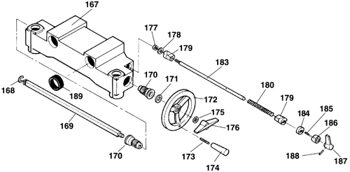

I know this is a long shot but, did you loosen the Table Height Lock (part #176)?
[ATTACH]26542[/ATTACH]
- Exp_510_520Carriage.gif (23.52 KiB) Viewed 6465 times
