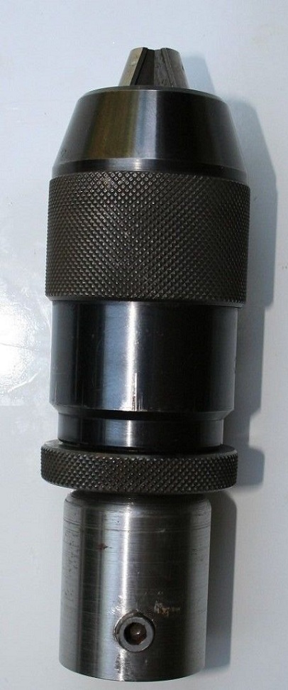

I bought one on Ebay that had been fabricated for $34. It was sold by Sh0psm1thjack
[ATTACH]26615[/ATTACH]
http://www.ebay.com/itm/Shopsmith-Drill ... 7675.l2557
However I only use it in the tail stock for boring pen blanks. The setscrew protrudes a bit and I never did check the angle to see if it matches the quill. Until I do bother to check it (if I ever do), it is very convenient and I feel no worries about it working loose since it is not turning.
Doubtful that I would be willing to pay what SS wants for theirs, but thsi was a decent bargain.
Be well,
Ben
- dr.JPG (102.79 KiB) Viewed 11055 times
