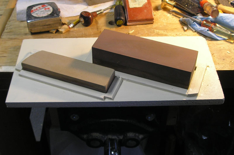

I have some sharpening stones (water type) and have tried a number of ways to hold them while using them - with most of my attempts being unsuccessful. With my push to use hand tools more often, I really, really need to keep my planes/chisels/whatever sharp(er) and, in a burst of frustration, I grabbed some crud wood and threw together a frame to hold my two stones in a vise and keep them from moving around. This is the result (painted with with some left over interior latex paint):
[ATTACH]26975[/ATTACH]

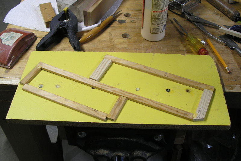

I took a piece of some sort of composite board, cut some pieces of trim board to size and build a 'wall' around the stones to hold them and then just glued the wood down (Titebond - no nails, no screws - just the holding power of the glue). Here is a picture with the trim pieces glued in place:
[ATTACH]26976[/ATTACH]

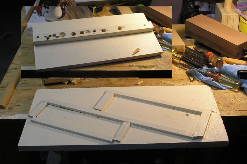

The board has a short 'fin' on the back which is dropped into the vise to hold everything in place - this shows the final part without the stones and shows the back side.
[ATTACH]26977[/ATTACH]
