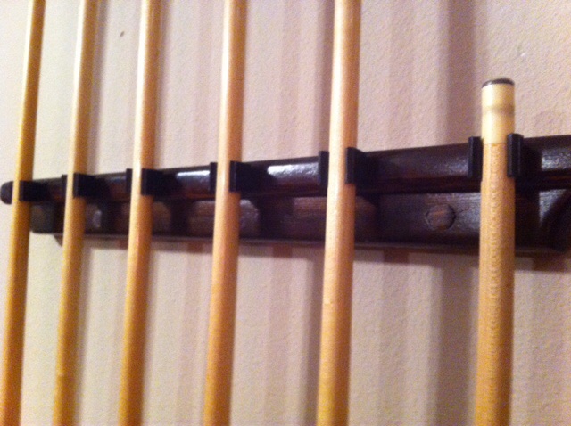

I'll attach some pics of the one I made for my game room. Average pool cue 57-58" high, rack top retainer about 11" from tip of cues, butt hole if cues have rubber buffers on bottom 1" if not about 1 1/4". This holder can be built in a cabinet. The top retainer clips were purchased from a billiard supply store.
- image.jpg (87.11 KiB) Viewed 11206 times

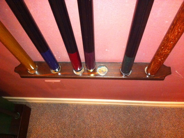

Photo 2, the bottom rack for the cues.
- image.jpg (102.86 KiB) Viewed 11206 times

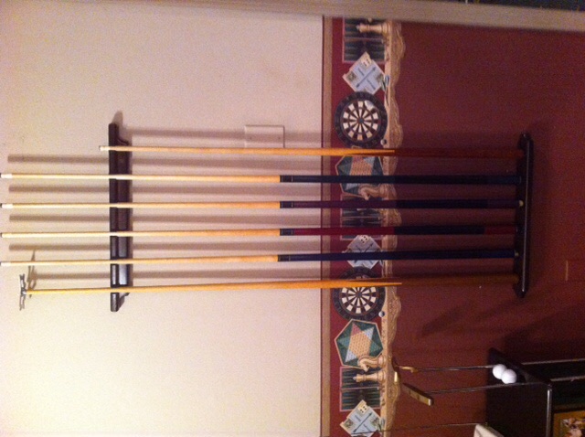

Re: Anyone ever build a pool cue rack?
The top retainer bar for the cues.
- image.jpg (92.71 KiB) Viewed 11206 times
