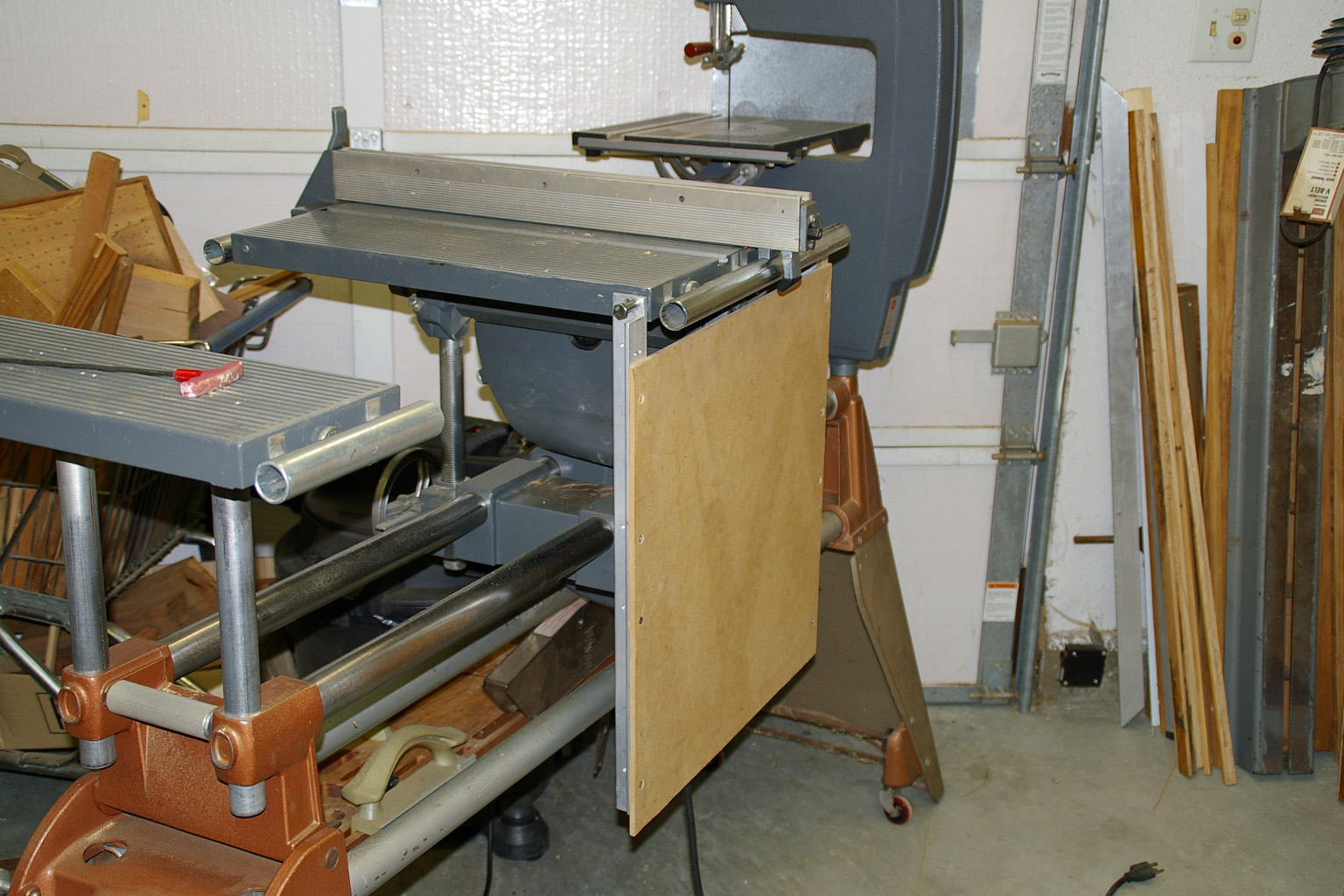

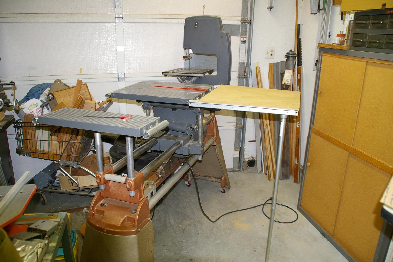

A couple of days ago I was ripping piece of expensive Claro Walnut to make another forearm for a Stevens 414 rifle when I made a mistake. I usually get the trusty support with rollers down to support the piece coming off the table. I got in a hurry and ripped it holding it down and sure enough, it popped up at the end of the cut and caught the saw blade. Good by "Claro".
I thought others have run into the same problem with arms that are not long enough!! :(
I made an extension using a couple pieces of aluminum angle iron and 1/4"
hard board. The table already had holes so I threaded the angle iron to accept 3/8" cap screws so it would not be necessary to put nuts on the inside. To remove the extension, simply back off the 3/8" cap screws. The hardboard holds everything together. For support for now I will use the telescoping legs. I want to use supports to the table carriage but the length would change with any change in table height. Gotta think about it some more.
I am like Dusty, I don't trust the telescoping legs.
Don G

Don, it looks as though you have solved a problem that I believe all Shopsmith users have, even those that have not recognized it yet. We need an outfeed table.
On yours, I suggest you set about ten pounds of weight out on the output edge of the table to check holding power of the telescopic leg.

Duty
I it is my intent to make a couple of supports with slots that can be "Locked" down with knob like on a "Tee" slot on a router table.
Don G
