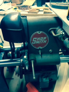

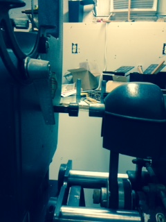

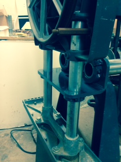

Bandsaw Mount on a 10ER
ChrisNeilan
Posts: 1463
Post by ChrisNeilan »
I'm in the process of refurbishing a Bandsaw (from 1992) to reside on my 10ER. I have the SPT mount from MKC Tools (a great piece by the way)and was looking to buy a set of longer tubes to mount the saw when I looked over at my unused Mark V extension table. Just as I was about to cut the tubes off their mount ( :eek: ) I had a V-8 Moment! Mount the table upside down in the SPT mount! It worked perfectly and saved the table for if I ever need it again! :)
