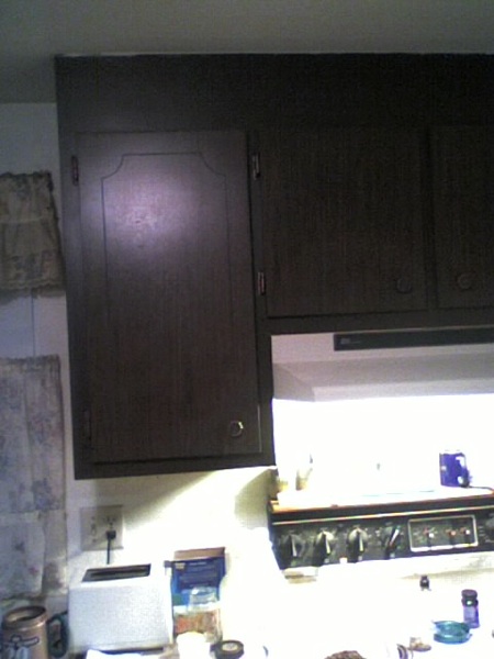

First shock came when I measured the kitchen. I knew it was small, but I didn’t realize that it was built low. The ceiling was only 91 inches high. That meant that the traditional 30 + 12 cabinets were out, and I was left with about 37 inches to play with.
The final plan settled down to upper cabinets 37” high with a permanent shelf at 11” from the top and adjustable shelves in the lower 26”. There would be a door for the upper with a glass or plexiglas insert, and raised panel doors for the lower shelves.
In the base cabinets, the use of a corner cabinet left a 6” space between the end of the corner cabinet and the start of the sink base. While I looked for and couldn’t find a small stepladder that might fit in this space, to make access to the upper upper cabinets easier, I finally found a narrow pullout shelf that would fit this space. The (sale) price was less that it would take me to buy the hardware, so I purchased it and the susans for the upper and lower cabinets when they went on sale.

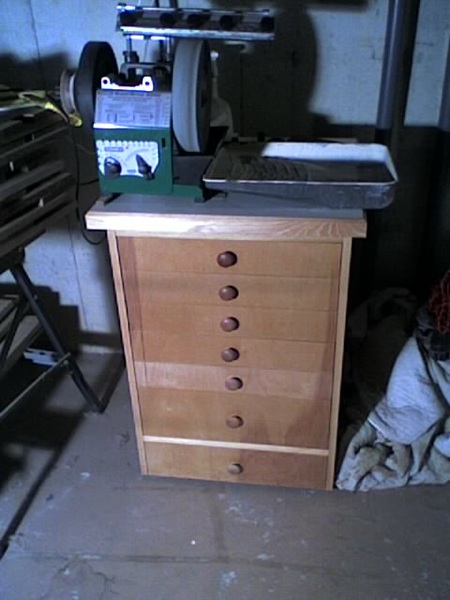

A caveat is that the blades have to be sharp. And I got a Tormek water stone sharpening system so that I could keep the blades sharp. And that started some of the “tools to make the tools to make the project” part of this project. Where to keep the Tormek ready, but out of the way? Norm Abram of the New Yankee Workshop built a sharpening stand, so that was answer one, and I built the stand.
Lesson: The planer blade is long, and will drip water as it runs back and forth. The top of the stand is protected by melamine, but the leather strop on he other side wasn’t. Simple answer: A small piece of wood under the leather strop side of the Tormek tilted it slightly to the right, meaning all the water now dropped off on the right side. To collect that water, a bread pan or cookie pan will collect the water. Now you have a neat top that isn’t leaking water from the length of the Tormek. The Tormek itself is sealed, so it isn’t a problem, and the slight tilt solves even most of that.

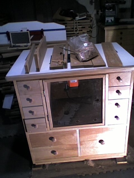

Since I knew that I was going to need a router table for the rails and styles, (or cope and sticks for some), I also built the Norm Abram Router workstation at this time. I have a SS OverArm Router table, but I wanted two setups, one for rails and one for styles, which would save time and setup errors - and wasted stock with trial cuts.

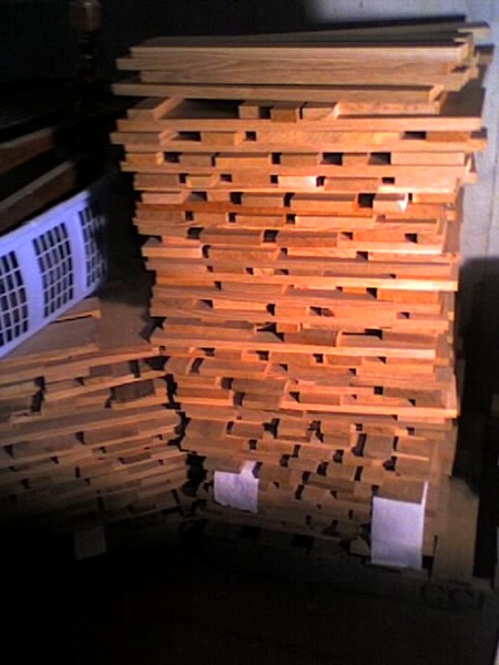

So to the planing. As I was doing the planing, I sorted the wood by length. Most of it came in lengths of 20 -23 inches, a couple were over four feet, and there were many that were under a foot in length. (Yes, there is a way to plane those if they are not TOO short, but I left some to be used in other projects or to be taken down by sander.
The sorting to lengths was further refined by sorting according to the type of grain. White oak that is properly quarter sawn has grain that runs vertical to the face in a lot a pieces. Those pieces show flecks that reflect light differently than the normal grain, and were one of the reasons I chose white oak. So the pieces were sorted by the condition of the surface showing these flecks. Those would be used for the visible parts of the cabinets. Non visible would use the other wood, and any pieces (suprisingly few) that had the grain running horizontally, were set aside.
Wood expands most along the grain, so that cabinets built using the vertical grain would get THICKER, but not by much with only 3/4 to start, and would not get much in the way of length difference, even with the base cabinet depth of 24”. As a consequence of this characteristic of wood, the cabinets are to be built with the boards running ACROSS the bottom and top of the cabinets, not running from front to back. This means that the top and bottom will be less likely to expand and contract themselves away from the sides, as I want this project to stay together for a little while at least. Thus, the sides and tops and bottoms will all be expanding and contracting from front to back, not side to side for the top and bottom and front to back for the sides.
This leaves the back, which will either be plywood or half lapped boards screwed individually to the side, the half laps leaving some room for expansion. Like a lot of other things, that is still up in the air, a bridge that I will cross when I come to it.

Here's some shots using my camera phone. The good camera is broken, so I will try this and see how it works.
It looks like it worked, so these show what I've described so far.
Kitchen Stove Cabinets-800x600.jpg (65.7 KiB) Viewed 8565 times
Planed wood-800x600.jpg (82.93 KiB) Viewed 8551 times
Sharpening Station-800x600.jpg (76.3 KiB) Viewed 8551 times
Router Station-800x600.jpg (75.78 KiB) Viewed 8553 times
