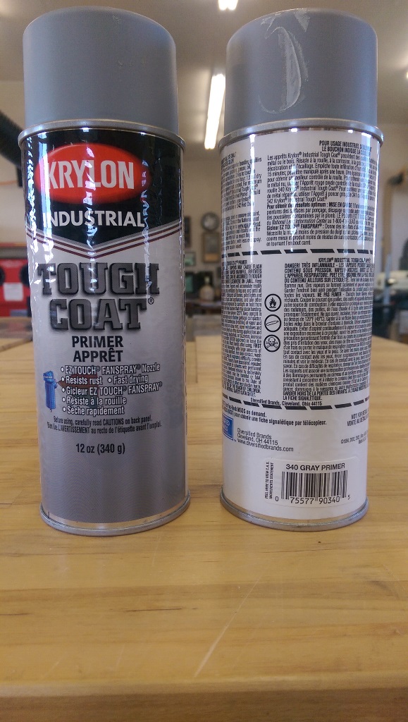

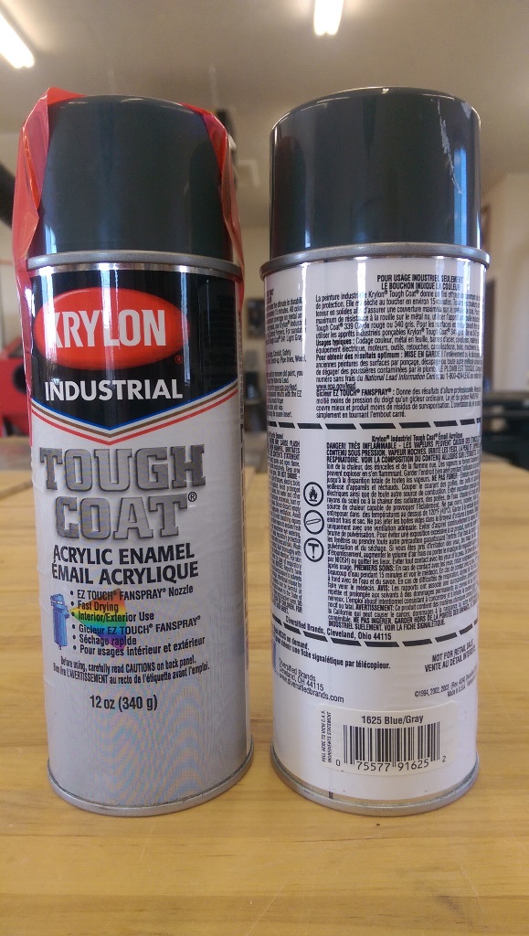

I think you are asking about the best paint not the best color. I don't know the "Best" paint. The best color is up to you. However, if you want the best match for the original color other than a custom mix then this is what Skip Campbell the undisputed 10ER guru and the owner of the Yahoo 10ER Users Group recommends.
Krylon Industrial Tough Coat
Primer 340 Grey
Paint 1625 Blue/Grey
It is hard to find. The big Box stores don't carry it. O'Rilleys auto parts has it but my local store did not have it. MSC Industrial has it and that is where I get it. MSC has a warehouse in Reno NV and I can get it here North of Salt Lake UT in a day or two.
